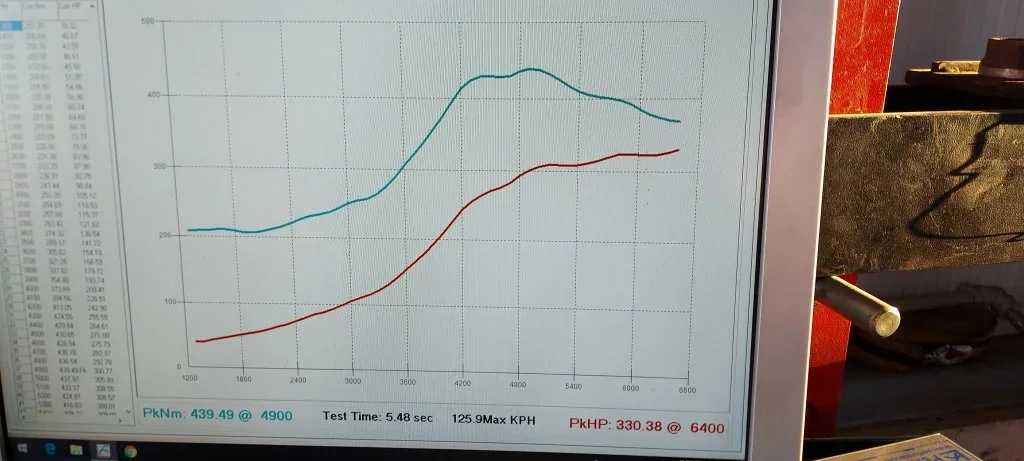

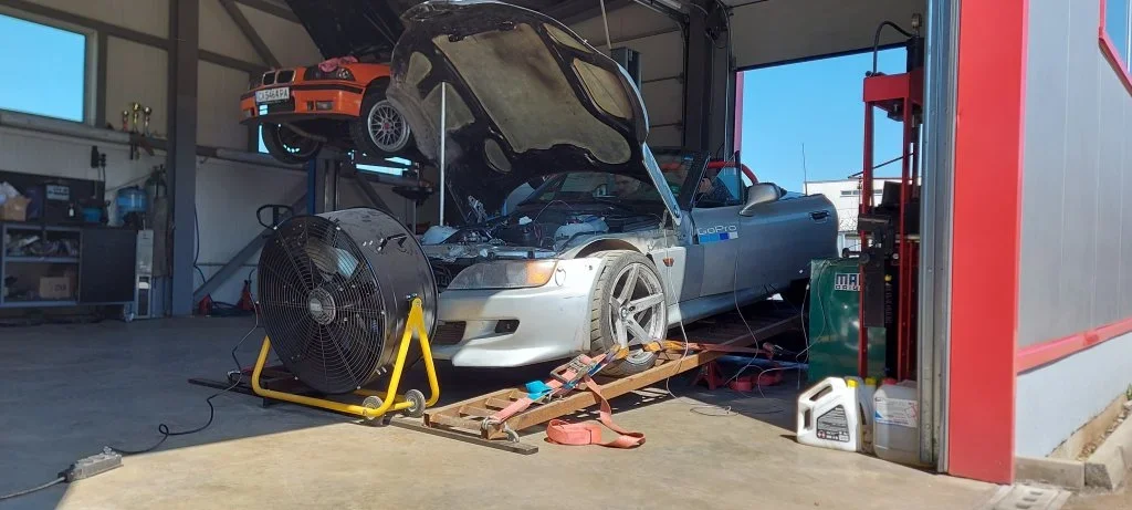

Hi Guys,
sorry for not posting updates ... but actually I got a lot now done ...
So - the car is now running!
Let me explain what I completed in the last months:

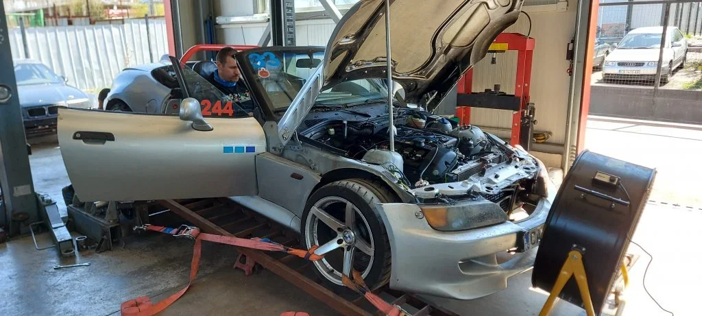

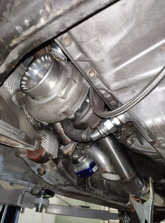

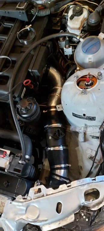

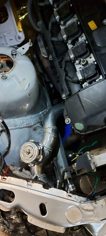

1. Engine -
I converted it to MS43, with manifold and throttle from M54b30.
Used 630cc injectors from Porsche, and Audi RS4 MAF
330 WHP and 440 WNM on 0.5 bar pressure. Mapped with the MS43
The car is a bit laggy, but I have to test it on the track first to take further actions. But for the cheapest manifold and turbo .. the result is great. I will upgrade to ball bearing turbo at later stage ... and the spool will be a bit earlier

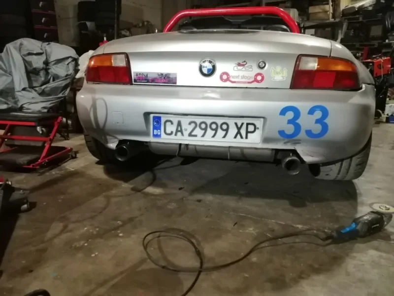

The exhaust is 76mm .. with single rear muffler from M135i / M235i ... and actually I am quite happy. It sounds and looks great.

After the updates from last spring... I added only ... a bit more boost :D :D :D
So .. after adding some boost controller, I drove the car at 0.8 bar of boost (its about 11.6 psi) the whole year. This means several hundred of kilometers, almost all of them on the track. No issues with the engine!
Here is the graph at this boost:
