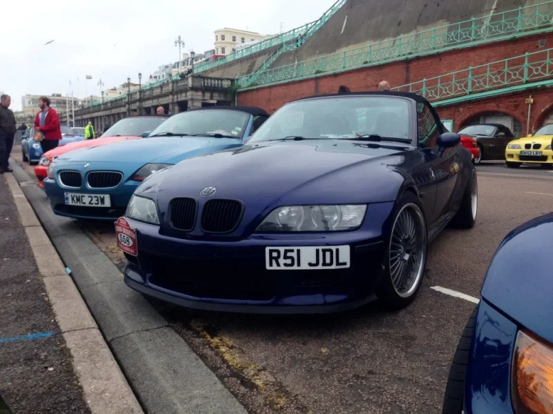

I got the lip via eBay, follow the link for the exact one, it's a rubber type rather than foam, been very sturdy and hides and marks from rubbing well.
Anyhow I've found a great cost effective, durable and black rubber customizable lip.
eBay link:
http://pages.ebay.com/link/?nav=item.view&alt=web&id=321742333048
As fitted to my car, I'll get better pics at the weekend.
I went for this over the cheaper foam lips as this is rubber and is certainly tough and had a smart matte finish.
Very easy to work with but if I do it again I'll just whip the bumper cover off for ease of working.
A little tip: I used some velcro self adhesive tape to position the lip and hold it in place and move it about until happy before drilling the screws in to secure it to the bumper (screws and plates supplied).
