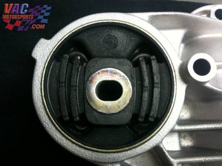

So getting back to diff bushes, having never seen what new one looks like I decided to google and see and came accross this Z3M version:
Quite a difference from what mine was looking like...
Very keen to feel what it will be like once refreshed!
Your new one will probably look like this though if @Lee has gone the same route as the other Zeds... Powerflex is a different design, but they are easier to fit as they don't need pressing in place.

Why does the Poweflex bush have a round hole in it and the OEM version a more oval looking hole?
Sound good!
Just a question @Lee:
I think it's for adding a little vibration to the seat area for your pleasure!! BMW thinks of everything to please their drivers and passengers
