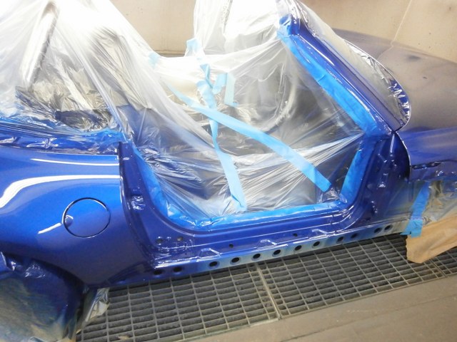

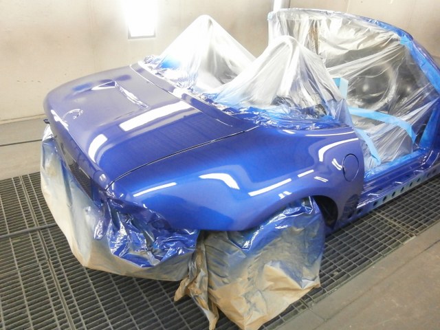

04/02/2014: Car taken to Sytner of Sheffield for full respray. The price is £1500+VAT. This is the price for the job if it is a "fill-in" job and takes the lowest priority in the workshop.
17/03/2014: Car collected from Sytner of Sheffield.
Full respray done by Sytner of Sheffield (it may look like Estoril, but it isn't :wink: ) - £1955

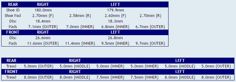

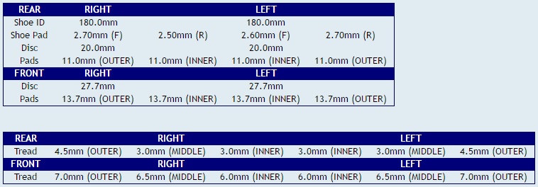

10/06/2014: Front wheels removed. Pads and discs measured and serviced.
16/06/2014: Rear wheels removed. Pads, discs and shoes measured and serviced.
14/07/2014 Signed off Inspection 2 [116,405 miles]

Replaced front discs and pads - £180

Replaced rear discs and pads - £185
