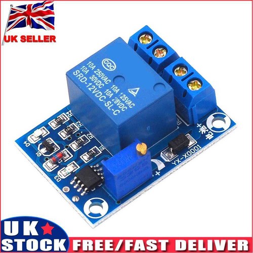

Looking at google tells me that it is much more than just sticking a Zener diode in series with the load.
I've just spent £15 getting together enough electronics to last me a few more years.
I could have bought a module for £5.50, but where's the fun in that?
Voltage cut-off circuit designed and built...

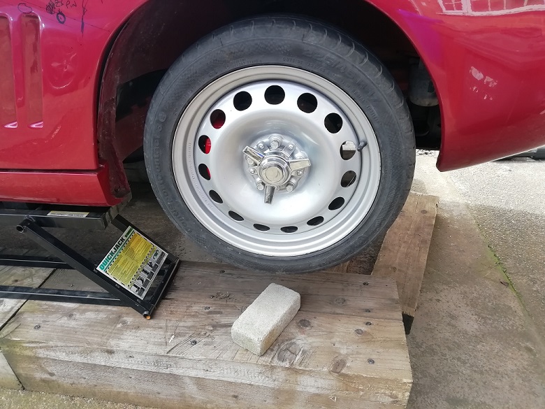

I've fitted the caster / camber plates and adjusted the height of the car. The caster plates don't give the full caster that an M should have, but they are better than standard.
The chassis has been checked for straightness, and the height was adjusted with reference to the chassis. There was 20mm difference left-to-right reference to the body (wheel arch to wheel centre).
The height has been averaged so it looks ok, but it may drive like a pig. We'll have to see.
I have still to check and adjust the camber and the tracking.
