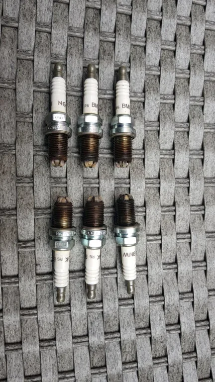

- Changed the spark plugs. From the very little service history I have for the car I believe it was last done in 2007 when the car was on 40,536 miles. It's now on 63,450. The existing plugs were NGK R5 spark plugs and changed to Bosch Super Plus FGR7DQP+.
From what I can tell I don't think there's anything alarming that jumps out when looking at the old plugs.
