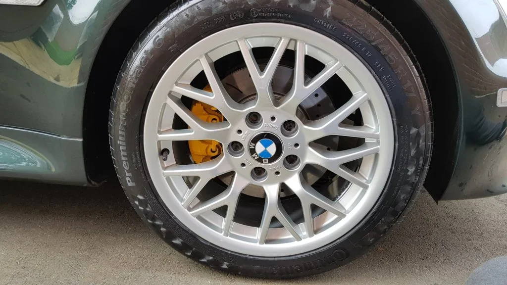

Managed to finally get hold of a set of Style 78 wheels thanks to @Brian H.
I'm not a massive fan of the shadow chrome so I've dropped them off at my local Lepsons to get them back to a nice shiny silver ready for some new rubber.

Got new tyres fitted to the newly refurbished wheels today. I decided to go for the Continental Premium Contact 6. 225/45 R17 91Y on the front and 245/40 R17 91Y on the rear. Once I've put them on I'll probably look into fitting some spacers aswell. Possibly 10mm and 15mm but will have to check.
