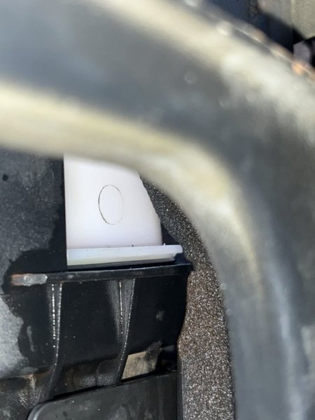

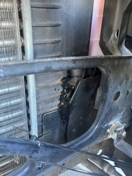

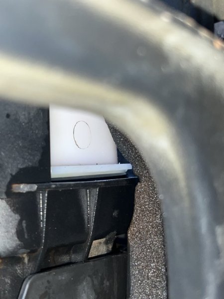

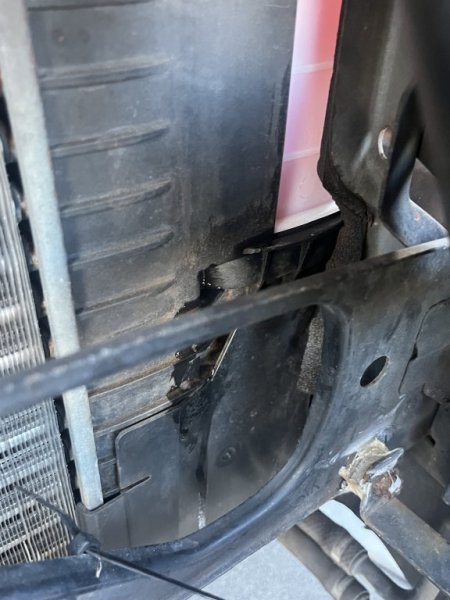

Still potentially leaking from bottom of expansion tank doesn’t look like it’s installing far enough the second o ring is still prominent as pictured.
