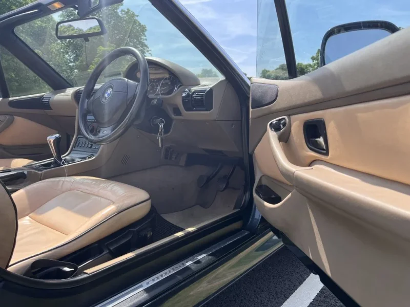

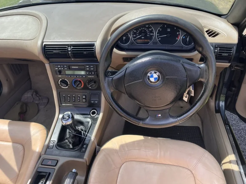

Ok, here is the final list of all that was done.. :coolsteer)
So, wanted to put her to the test and she passed with flying colours -(Just got back from a 250-mile round trip to Norfolk to visit friends and family).
