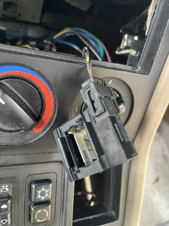

You can change the switch without removing the steering wheel I didn't take mine off when I fitted obc to the Dakar
all done fitted the stalk this morning found it easier to remove the steering wheel as its not in the way... went for a run today to hereford round trip about 60 miles... did try altering the KVBR setting from 1000 to 900 and the obc was reporting better economy more like what i am getting
Anyone with a 1.9 m44 with an OBC fitted like to comment on what their KVBR setting is ?
