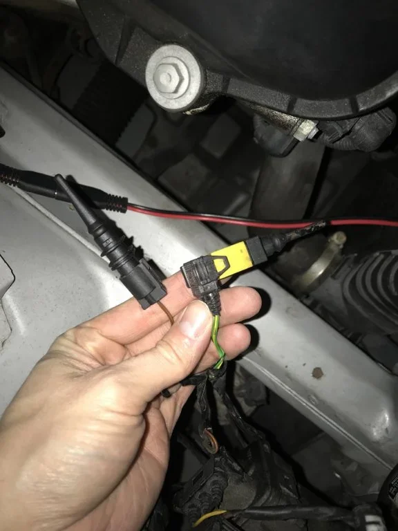

The wires are secured with some tape behind the headlamp, the second picture shows you the actual connector with the dust cap on, after its been released and the tape peeled off.
I found a connector like in the photo with a dust cap on behind the drivers side headlamp.The wires are secured with some tape behind the headlamp, the second picture shows you the actual connector with the dust cap on, after its been released and the tape peeled off.
Hi, mine worked straight away after i plugged it in, by the way this is the temp probe plug on mine.Evening all, i've just finished retrofitting an OBC to my 2002 Z3.
Stalk works, all of the features work, except 1. I bought a second hand temperature sensor and i don't know if it's working.
The OBC beeps on start up and says -40.0'C but i'm not sure what is the route cause fault?
Sensor or does it need coding? Maybe i plugged the sensor into the wrong connector? Suggestions?
Is there anyway to test the air temperature sensor?
Which colour cables is the sensor meant to be plugged into?
Evening. What year is yours? I’m thinking that the facelift version uses a different sensor? It still doesn’t work on mineHi, mine worked straight away after i plugged it in, by the way this is the temp probe plug on mine.
Mine is Oct 97, and this is the sensor on mine.Evening. What year is yours? I’m thinking that the facelift version uses a different sensor? It still doesn’t work on mine
Tried the exact same sensor on mine. Didn’t work. And I’ve check the cable and sensor. Both carrying current. Might try the E46 sensor before buying another E36 one.Mine is Oct 97, and this is the sensor on mine.
Worth a try. Pm any members with a 2.2, I know @pgunter has one.Tried the exact same sensor on mine. Didn’t work. And I’ve check the cable and sensor. Both carrying current. Might try the E46 sensor before buying another E36 one.
