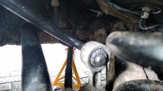

When I replaced mine (along with the top mounts) didn't notice too much of a difference.The main purpose of the shocks is to stop you getting a bouncy ride that just having springs would cause I can't imagine they would sort out your 'lean'. On the other hand, replacing the ARB bushes and drop links mad a great deal of difference to body roll.

I don't think you're wrong to replace 75k old shocks, I just don't think you'll get the improvement you're after. The good news is that the bits that will improve your body roll are quite a bit cheaper than the shocks....they're just a bit of a bugger to fit:(.
My shocks were 85k old and my rear end was skipping over rough surfaces and not gripping out of bends properly, but I could also see that my ARB drop links were in a poor condition (see below) which is why I replaced them and the ARB bushes too. I did the shocks and top mounts first and found not much of an improvement in the grip out of bends and only a slight improvement in the skipping. The ARB refresh sorted this all out and now it's very hard to get the back end to step out....and I trust me I've tried!:cool:
