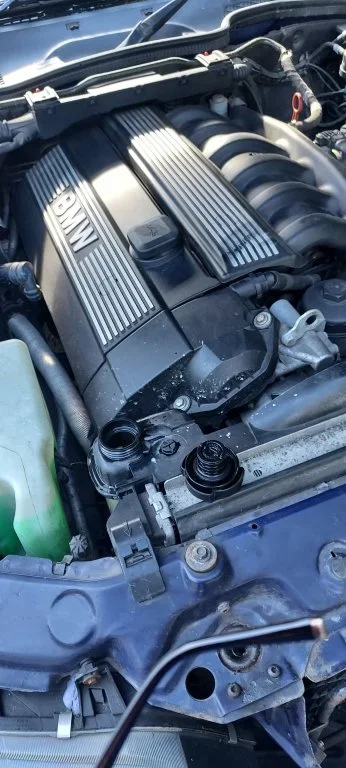

Ok, just overheated on the drive home.... no obvious leaks in the system. Tiny bit of spray onto the engine cover from the expansion tank.
Thoughts?
Thermostat faulty, not fully opened and restricting circulation.
Ok replaced the thermostat last week, still overheating. I switched everything off and listened, I could hear hissing from the aluminium housing i put on a year ago, i guess it had warped a little.
Fitted an oem housing today, just done a 20 mile run with no issues. My temp gage is sitting perfectly in the middle and its blowing hot air when idling.
Result!
