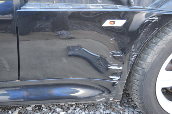

Well finished work for a couple of days so I managed to get a couple of hours free to start working on the Z project today, hopefully more time can be spent on her this week.
I must speak to my wife and children to come up with a proper name for her -" Z Project " just wont do.
So firstly after trolling through this forum,along with a couple of other "Z" dedicated forums I was able gain some much needed knowledge on removal of some of the damaged panels .
I am going to be posting lots of pictures as I go along for anyone who is interested in the development of the car, or just so people can look to see how things come apart etc.
If I am posting too many pictures , stuff people are not interested in or people want me to try and take certain pics then please let me know.
Jobs completed today -
1- N/S front wing removal. Straight forward task - 4 screws to be removed - 8mm socket required
2- O/S front wing removal
3 O/S sill cover removed - This was a little bit harder - I removed the scuff guard and the plastic trim that runs up the rear wing. then it was a case off undoing the self tapping screws again an 8mm socket.
DSC_0233.JPG DSC_0234.JPG DSC_0235.JPG DSC_0236.JPG DSC_0237.JPG DSC_0238.JPG

Great little project DD, most of the panel damage seems cosmetic and many are bolt on/off panels, well done for saving it. It may just be the angle of the picture but the rear wheel in picture just does not look straight , maybe something to check as well?
Thanks for the comments Brian.
I had a look at the wheel alignment today after your comment, and thank you for mentioning it.
I think as you stated its probably the camera angle or how the rear bumper is not sitting right that makes it look like there is a problem with the wheel alignment
Both wheels do tapper in a little from bottom to top, but I think its how they are set up camber wise.
Toe in/out wise they look straight.
Mark
Mark
They do run negative camber on the rear Mark (which is not adjustable by the way) so it pays to keep an eye on tyre wear and have them turned on the rims before they get too much wear on the inner shoulders. That way you'll get more wear out of them.
