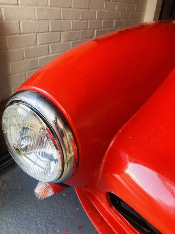

The gelcoat is actually grey (RAL-7015).
Although i'm sure the gelcoat can't be exact. Chris's phone gave it a blue tinge.
Although I'm quite liking that colour in the picture. Wonder if I should paint it like that. Although I have got grey car in my mind with red soft top and hints of red in the cabin. No hurry.
@Dxbolton On the picture I posted you can clearly see the light coloured lines around the headlights and along the top of the wings. This, I imagine, is where panels have been bonded. So wouldn't that lighter colour go all the way through? Only curious because you said you'd rubbed your down and that lines goes away?
No problem once it's painted but I wanted to delay paint for a while while I decide what colour to paint it.

The lighter lines are the mould joins and stick upwards. When you file them down it blends into the original colour as below
Dxbolton
Jun 19, 2020
114
New Forest
2.8 auto
When the moulds are bolted together the gel coat sinks into the crevices so it should all be the same colour. Underneath you still have 1mm or thereabouts of the gel coat over the whole body
