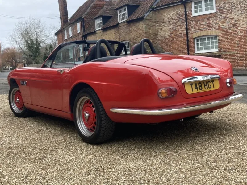

@Dxbolton The bootlid handle. You've filled the 500 and attached 507. What's the handle made of?
It’s the original Fiat 500 handle.
I had the 507 3D printed by a friend and then I stuck it in position with Tiger Seal.
After fettling and priming the entire handle was painted with Hydrachrome paint.
It needs doing again properly as the first company never sealed it properly, but and I have now found someone who can do it.
An alternative would be to buy bmw 750 chrome numbers off eBay and just reordering them before gluing in place.
The bumpers and grilles are being painted as we speak
Hope this helps

My z3 is a pre-facelift narrow body.
@Dxbolton When I get the tribute 507 back end on is it going to look weird with the arches quite a bit wider than the wheels?
I don't really fancy spacers. Might go for deep dish wheels but would wide body trailing arms be a an idea? Or would anything else need changing too? (As well as wide body inner splash guard things.)

@Duncodin i used bmw winter steels that are slightly deeper dish than standard.
The fitment looks perfect to me without spacers
I don’t think the suspension is any different between narrow and wide body, @t-tony can probably confirm this
The part numbers of the trailing arms on a 1999 1.9 narrow body isn't the same as a 1999 2.8 (widebody?) So I assumed the narrow body trailing arms placed the hub a little further in on the narrow body compared to the later (wide body)
IIRC the narrow body rear beam is narrower but all others are the same except ///M models. Andy @spurs fan in a coupe may have better info.
