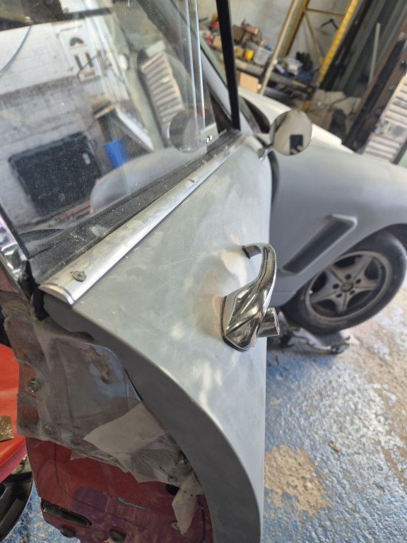

Looking very good! 👍 I can only imagine what kind of feeling you have right now when you start to see the result after all hard work.
i just got my kit few weeks ago and I have just test assembled the rear of the kit.
There are a few hours left for me 😁
A question, was it possible to install the door handles lower? I would like to have mine a bit lower but still maintain the original door locks from z3.
I thought the handles look a bit high TBH, as they seem to be pointing up.

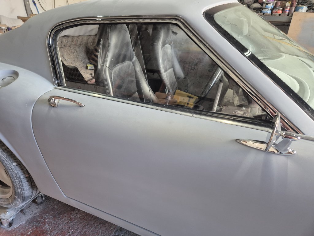

Thanks, yes im loving putting it together at last. Yes you can have the door handles lower. Ive bought the grassbank ones that come with a template/jig to set up using cables to work the lock. They dont use the existing z3 handle/mechanism. So you can have yours sat lower. Im comfortable where mine are. ... although on reflection I may lower them a little

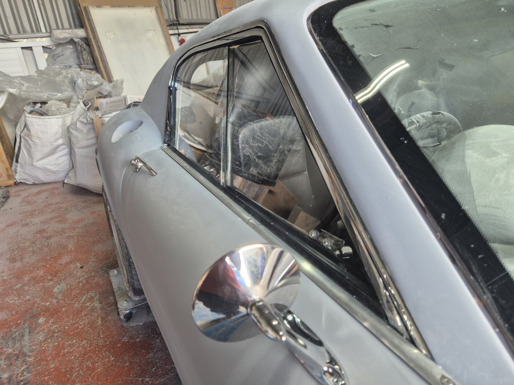

Lowered a little. Actually sit nicely against body better now. Not as low as z3 handles but i like the fit now. Isn't fibreglass great!!

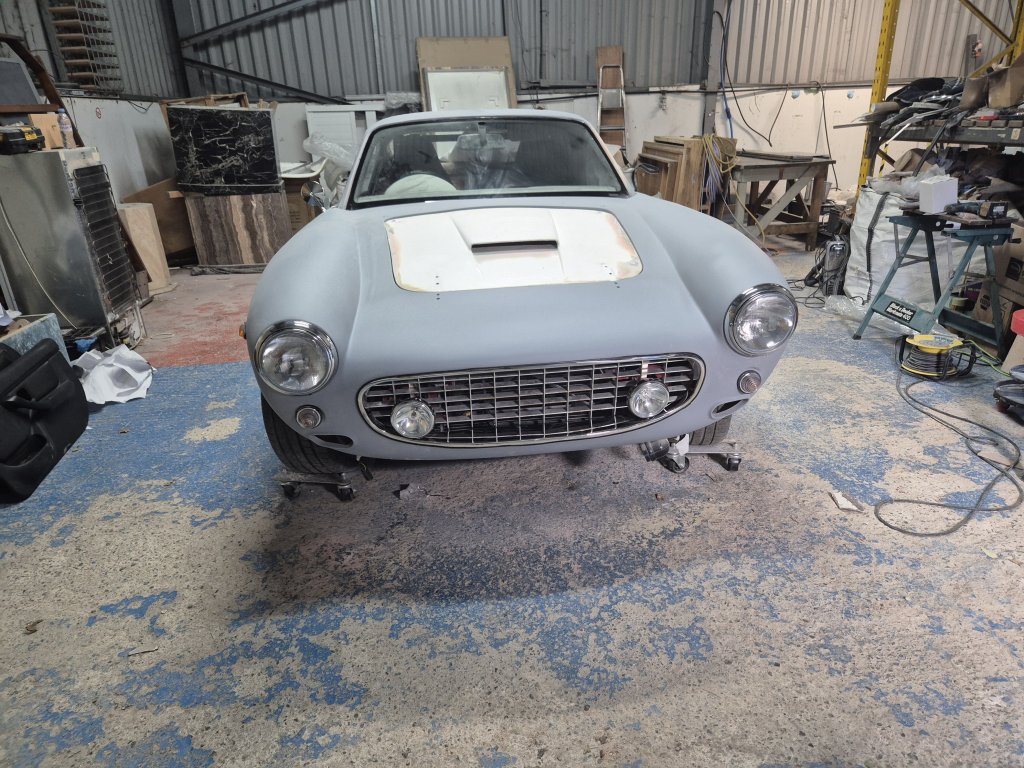

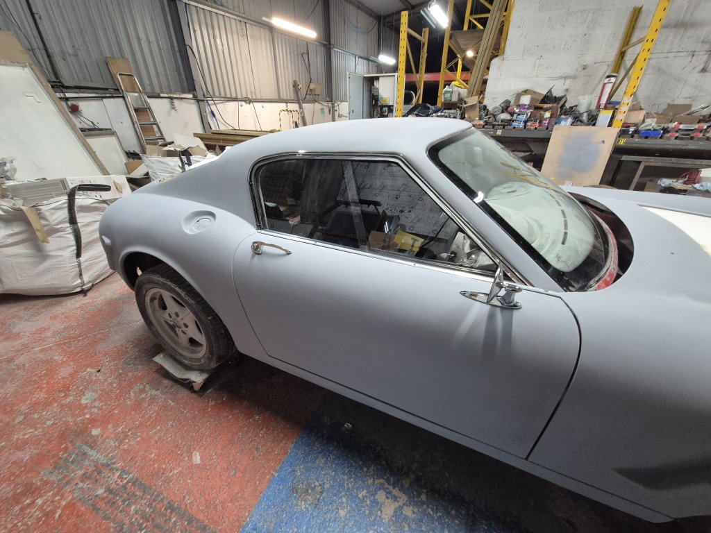

Had to move out of the unit i was building it in so now have it at home in the garage.
Got it road legal and trimmed it up to show the bodyshop what I want.
I think I'm going to drive it for a few weeks to test it. Find some cobbled roads etc and see how the body reacts to its fixings / see if any cracks appear
