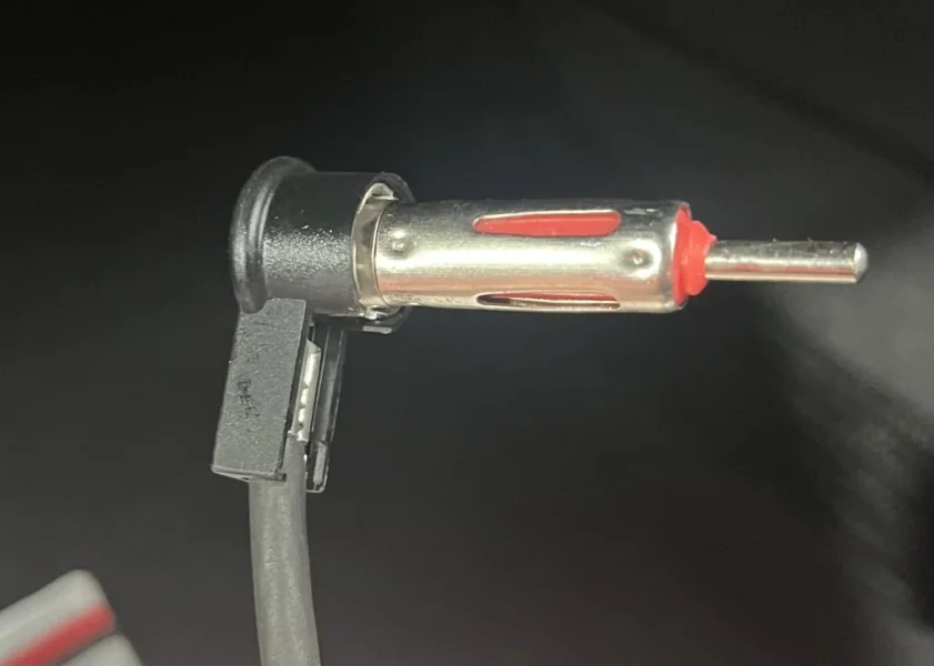

Then if this is the aerial plug ?
What is the thick
cable and small white plug for?

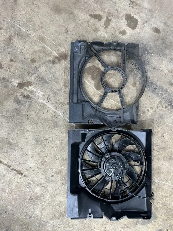

I received it from our Post lady yesterday like a kid at Christmas. Excitedly I thought “ All buttoned by lunchtime”. And it should have been.
But how wrong I was!
A quick comparison with my existing shroud began the alarm bells ringing.
Whilst there were broad similarities, there were some very obvious differences. The shroud is much deeper top to bottom, though this is actually a benefit enclosing the complete condenser making it more efficient.
However I could see there was going to be an issue with a duct like add-on in the top right hand corner. When offered up to the car this duct was never going to allow it to move upinto position.
Having done so much research I did not want to give up on fitting it without more thought.
I checked the locating positions and it seemed to be broadly the same as my existing shroud.
My conclusion was I had four options:
1. Send it back - but that would still leave me looking for an alternative, with no certainty it would fit any better.
2. Try swapping the motor onto my shroud - but there was no guarantee it would fit
3. Buy a used one, but it would be 25 years old and have an indeterminate life expectancy.
4. Commit, and chop the offending duct off and hope I could then make the shroud fit.
I chose 4 !
Cutting the duct off was easy, and had no detrimental effect on the shroud or fan.
“Great”, I thought: it will now be straightforward.
3 hours later I packed up, tired, dejected and thoroughly p****d off with pattern parts that don’t fit. Like a table cloth that is too small no amount of re-positioning would make it fit 😤
After sleeping on it, the thought struck me that it might be the brackets on the Nissen after market condenser that were out of alignment. However, a quick check this morning showed they were lined up nicely for my old shroud: so back to the NRF being the issue.
The main problems were that the fan attaches to the Aircon condenser but sandwiches a front brace between them on the 2.8.
(This brace is not fitted on 1.9s, hence why a shroud from it would not fit).
There are cut outs in the shroud perimeter flange to fit over this brace. This then tightly positions the shroud relative the cars chassis. However the shroud was not high enough relative to the fixings on the condenser.
To cut a longer story short, I had to cut a further 10mm from the shrouds top flange, remove some material from one of the lower condenser brackets and more from the shroud where it still fouled: then undo the condenser mounts to the slam panel, and fix the fan shroud to a “floating” condenser. Finally I used some judicious encouragement - ie brute force! - to push the shroud up to reach the slam panel fixings.
So tonight at 7.10pm after 2 days of my “unchallenged ride onto the Champs Elysees” I have finally emerged victorious: my Aircon system is completely installed……….

If it helps, my '97 1.9 does has the front brace.
Thank you for your information: that just compounds my confusion!😂
I wonder what BMWs rationale was…..?
Interesting.
I really don’t understand what is going on?🥴
The cowl I was offered by a long time Z3 enthusiast, who owns 5 of them, from a 1.9 pre facelift, did not have any cut outs in the perimeter, so definitely would not have fitted over this brace panel (without modification), and presumably never had the brace panel fitted?

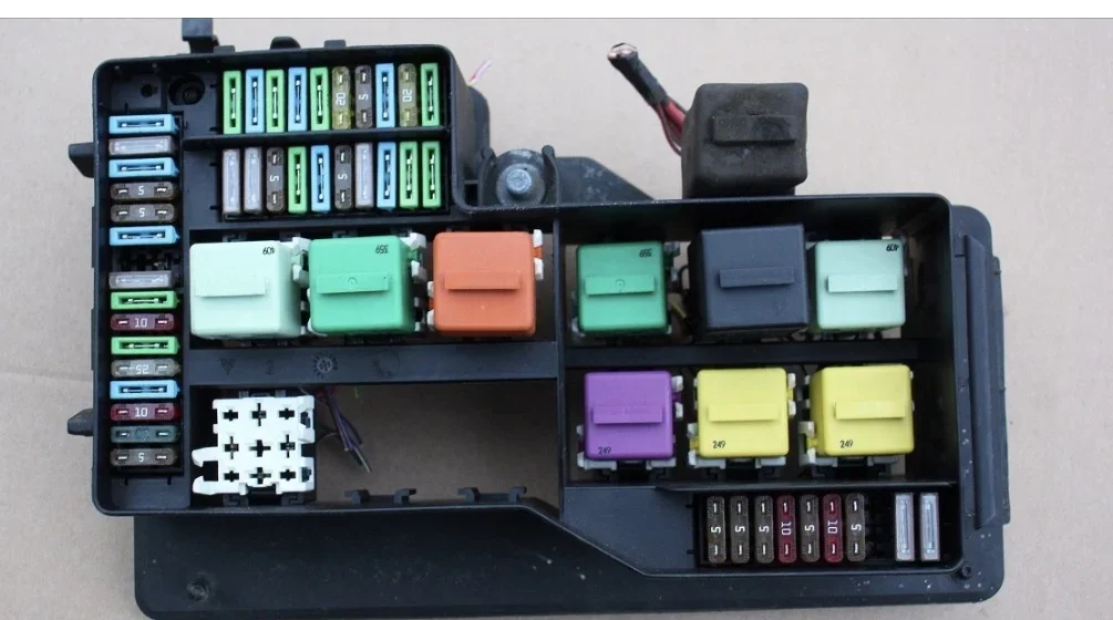

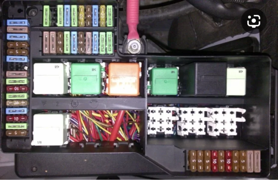

There are also 3 relays to be fitted in the main fuse box under the bonnet - reference 13, 14, & 15

Installation was incredibly easy and it quite literally started playing the moment I plugged it in!
