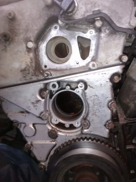

M44 coolant pump refusing to `come out'
Some gentle heating around the pump might help.

I've always done it with bolts. I did have one fail but it was on a breaker (albeit trying to recover a nearly new pump). I put it down to using low grade bolts which sheared off. Haven't done one since but will be using grade 8.8 bolts.

Have to confess I've never used a slide hammer so cannot comment - I'm sure there are a few guys on here who can advise - @Lee , @t-tony @mrscalex to name a few (other brands are available ;)).
My method meant I was not putting a force inwards against the plate but pulling the pump outwards with the plate attached by the seal.
I do not have A/C so on the M44 there was plenty of room. I would suggest you put the puller on and give it a gentle squeeze - with luck it will move.
I'm kinda regreting that I did not start or warm up the car first before doing the water pump. I'm in the last stages of my cooling system overhaul. I didn't want the new heater hose running from the cylinder head be put on an old radiator because it's a pain to remove hoses once they're set. So I decided to just remove the old radiator and thermostat but the water pump happened.... But oh well
An electric heat gun may be enough if you have one.

By the way did you ever use WD-40 to help pull it out? I hear others have used it to help pull the water pump out.
You can get a spray to "freeze" things, this might be a better way to go if you can get some. Spray the water pump body not the housing.
Certainly did refer to initial comments - left it soaking overnight - once it started to move slowly continued spraying.

WD40 is not really ideal for freeing seized parts. Shell out the extra and buy PlusGas releasing fluid-MUCH more effective-in fact it has never let me down.

I did my M44 cooling system overhaul in the Summer. It won't help now but, when I wound the two bolts in to push the pump out, I was careful to ensure they were both seated and tightened equally and at a quarter of one turn at a time. After each equal tweak, I tapped the pump body lightly with a hammer. It is very easy to effectively jamb the pump body in the aperture by forcing it out, out of square. My car is a 97 and it was the original pump.

Same here. But like others, even if you're careful, the pump can be pretty seized with a hardened o-ring for the previous owner didn't replace it on time. The longer you wait, the higher probability the o-ring gets stuck.
It's the same thing when I replaced the cooling pipes on the block and cylinder head, they were hardened such that it was difficult to removed until I twisted them.
I saw yellowish deposits as well which I believe is from the previous coolant. The previous owner didn't use BMW BLUE but an amber coolant perhaps Zerex G-05 or Peak Global Lifetime. This then convinced me further to use BMW BLUE and following an interval change.

I do not know what my car's previous owner used but having seen some of the tricks `he' pulled if it had been changed I doubt whether it was BMW spec . However, there were no deposits and O ring did not feel hardened - mileage was 64k.
I have used Comma X GS 48 since (which complies with BMW specification) at three year change interval - you can get it at reasonable on-line prices.

Diesel is much better than canned sprays. Good in squirt bottles or in old tins to soak "frozen" or rusted parts in overnight.

I will add that when I fitted the replacement pump, I lubricated the rubber seal with silicon grease. The next poor soul will probably thank me for this!

Is white lithium grease okay?
I'm deciding what to put on the water pump o-ring to ensure easy removal later on.
GS-48 is the equivalent of BMW Blue. GS-48 here is not easily available. It's supposed to be under a xerex valvoline brand but I see mostly GS-05.
