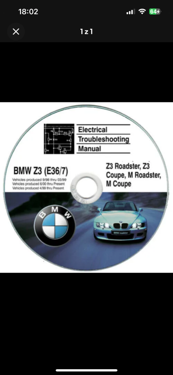

There is definitely a gap in the electrical trouble shooting manuals, my specific model doesn’t seem to exist @Lee mentioned the x20 and x69 plugs I’m supposed to have near fusebox, and on the ETM they are there on the picture on an m43 z3, but mine doesn’t have this, only thing I can think of is the ETM says BMW NA on them, North America I’m guessing which might have different wiring to the UK models, also I the manual goes up to march 1999, my car was made in August. If I go on the next ETM up one year newer, it only has information about 6cylinders
Was thinking about getting this
edit - never mind it would just show the same stuff as the ETMs I have seen on internet, therefore being useless
