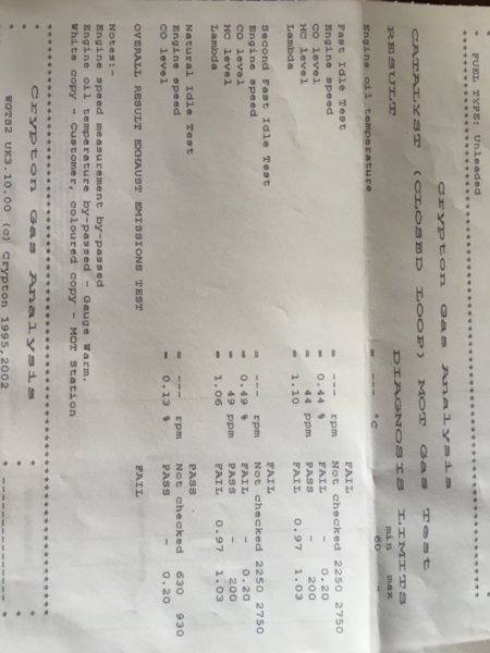

here is mine, failed today on the emissions again (also has a crack in the windscreen, quite big and the horn wasn't working, it was working yesterday when the tit in the golf nearly got hit in the ar** when he decided to swap lanes without looking or indicating)
I seem to recall it was co fail before.
I would go back with the car HOT and insist that they test the oil temperature before doing the cat test. Many cars fail the BET test and pass if the correct procedure is followed. This is the only way to know if you've improved anything because you're testing the emissions at a known temperature, otherwise it's pure guess work.

Mine fails on the co2 every year Jason, slightly higher reading than yours.
Jason, am I right in thinking your car is a 1.9? Have a look online for the VOSA In Service Exhaust Emission Standars for Road Vehicles. If it has an engine code of 19 4S1 the C.O. Failure level rises to 0.5 % at which your car would have passed?
