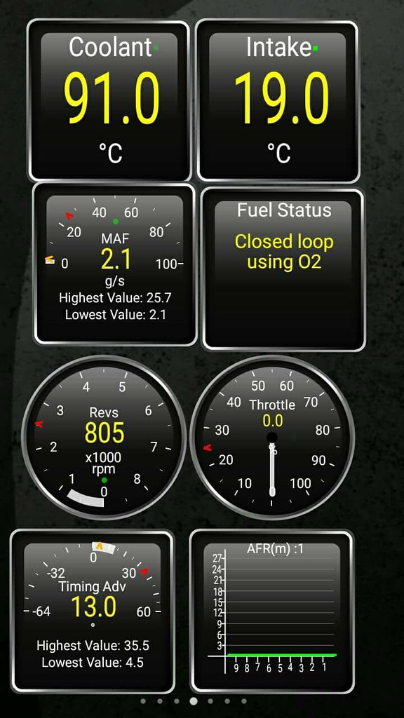

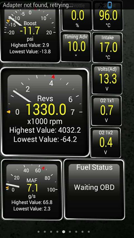

the anndroid torque app and a bluetooth OBD reader is great for live monitoring. i use an old android phone running the torque app and keep it running in the car it tells me when car is up to temperature and warns me of engine overheating, fault codes and When @GZed was driving it told me that he was using more that 50% throttle pedal travel....:-(
honestly its a must have tool to have in the car... i just stick the mobile to my windscreen or place it in the little tray by the handbrake..
