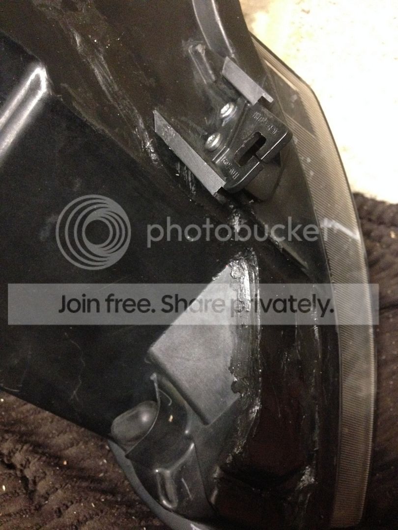

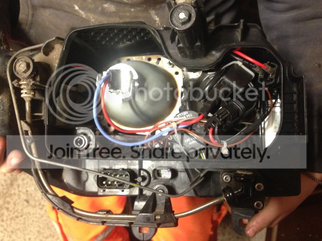

did this a few weeks ago but not had time to write it up...

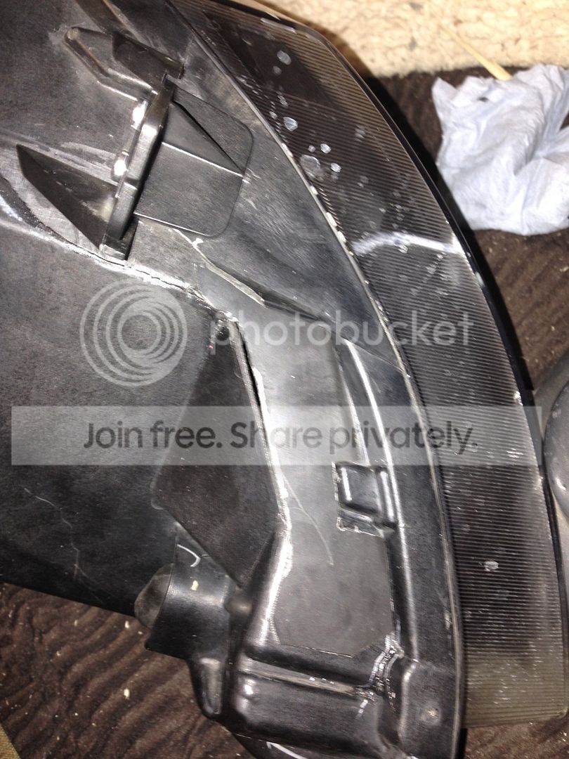

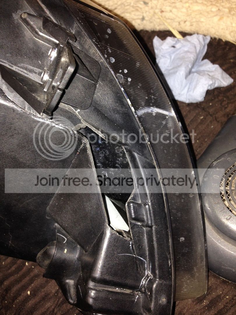

passengers side headlight kept letting water in, removed headlight to investigate and found a couple of brackets had snapped off, ordered a repair kit and set about repairing the large hole..
broken lug and hole:
plastic cut to size:
all sealed up water tight and fixing lugs replaced:

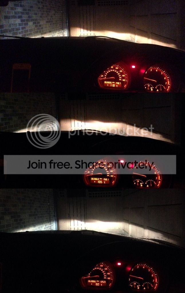

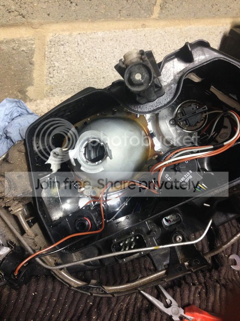

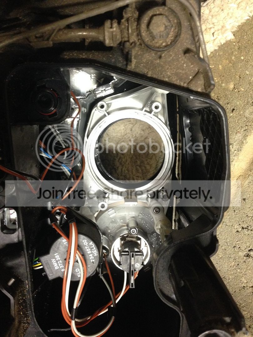

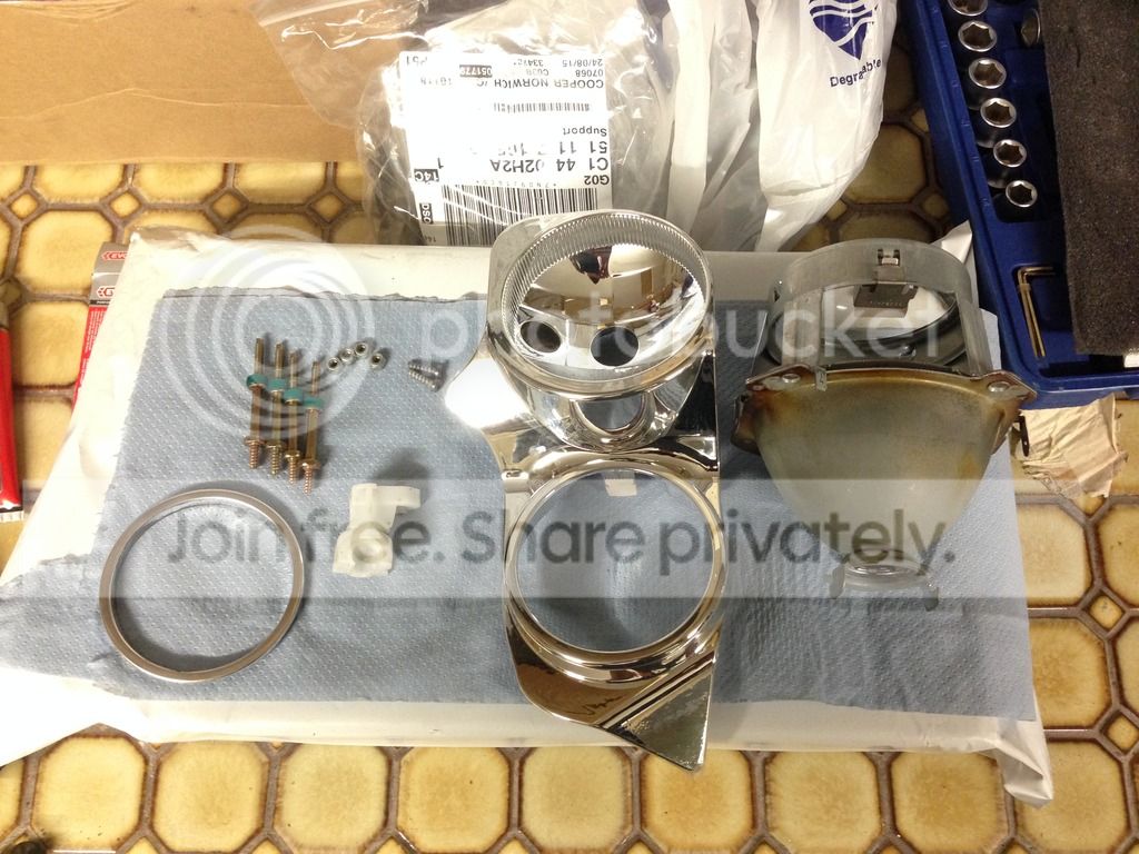

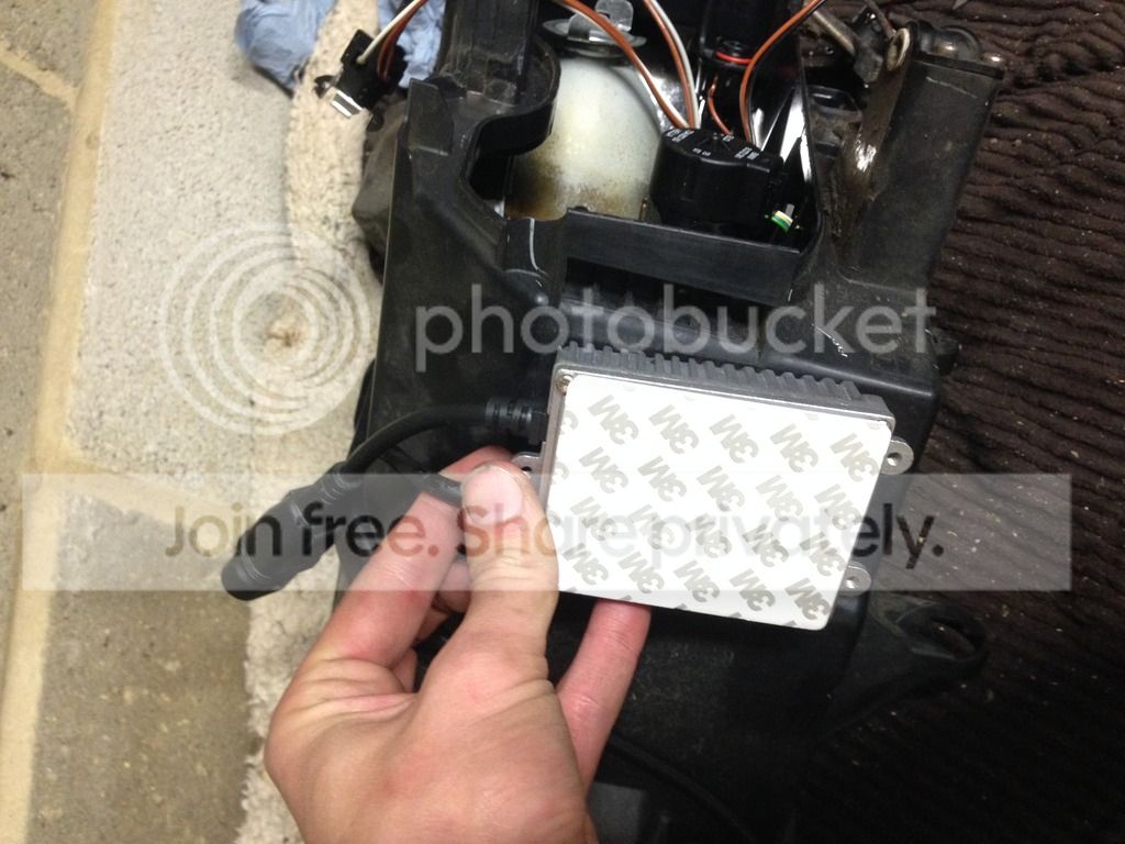

had enough of the poor light output from the standard Halogen lights so decided to upgrade to some 55w HIDs in 6000K
removed light and gave them a good clean and dry out:
reflector lamp removed to allow better cleaning etc:
stripped down for a good clean:
mounted the ballast on the inside, in this area:
rough location of all wires etc when fitted and replaced:
finished light output:
Top = standard lights/bulbs
Middle = standard lights/upgraded Osram night breaker bulbs
Bottom = 55w HID kit with 6000K

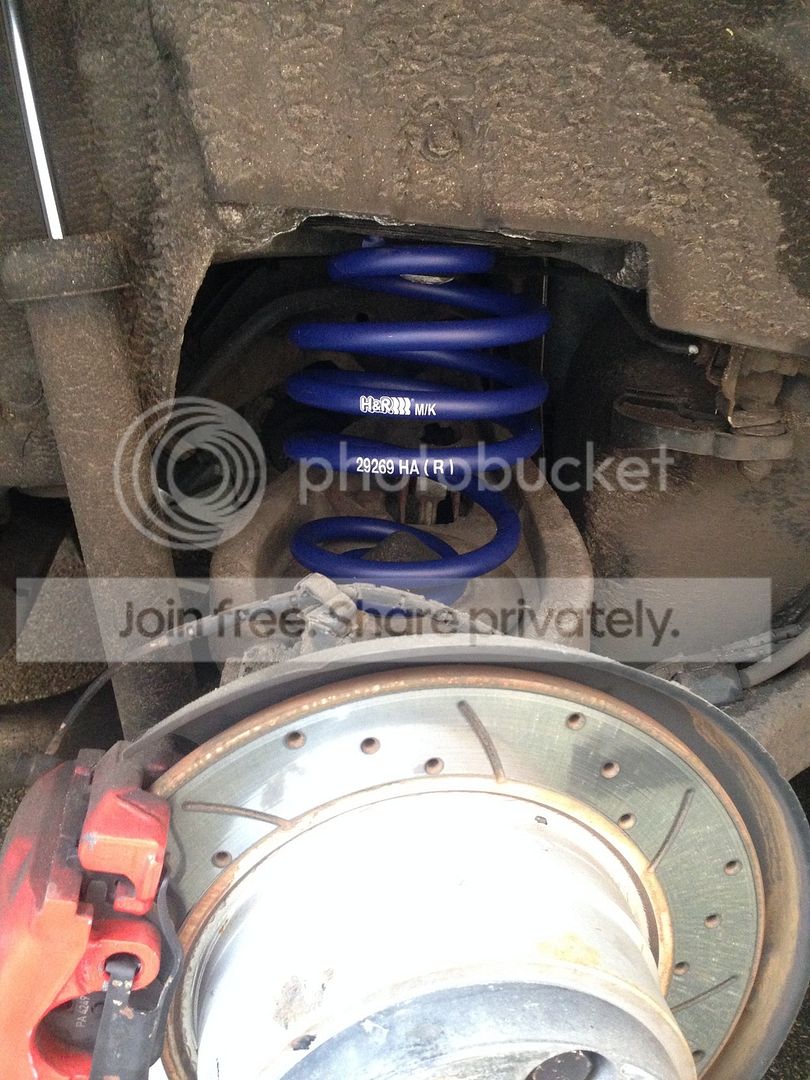

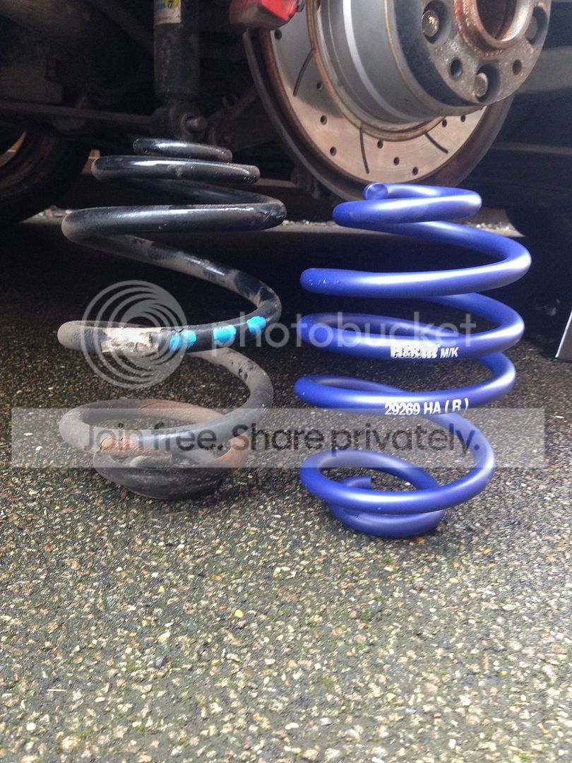

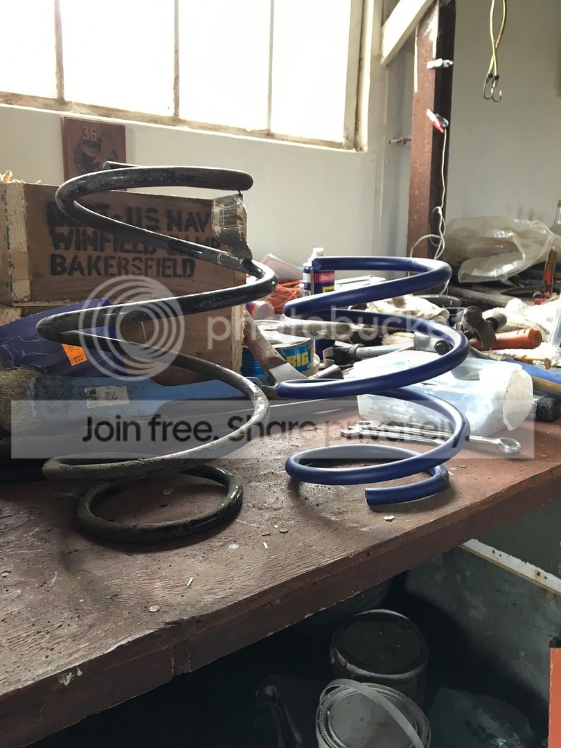

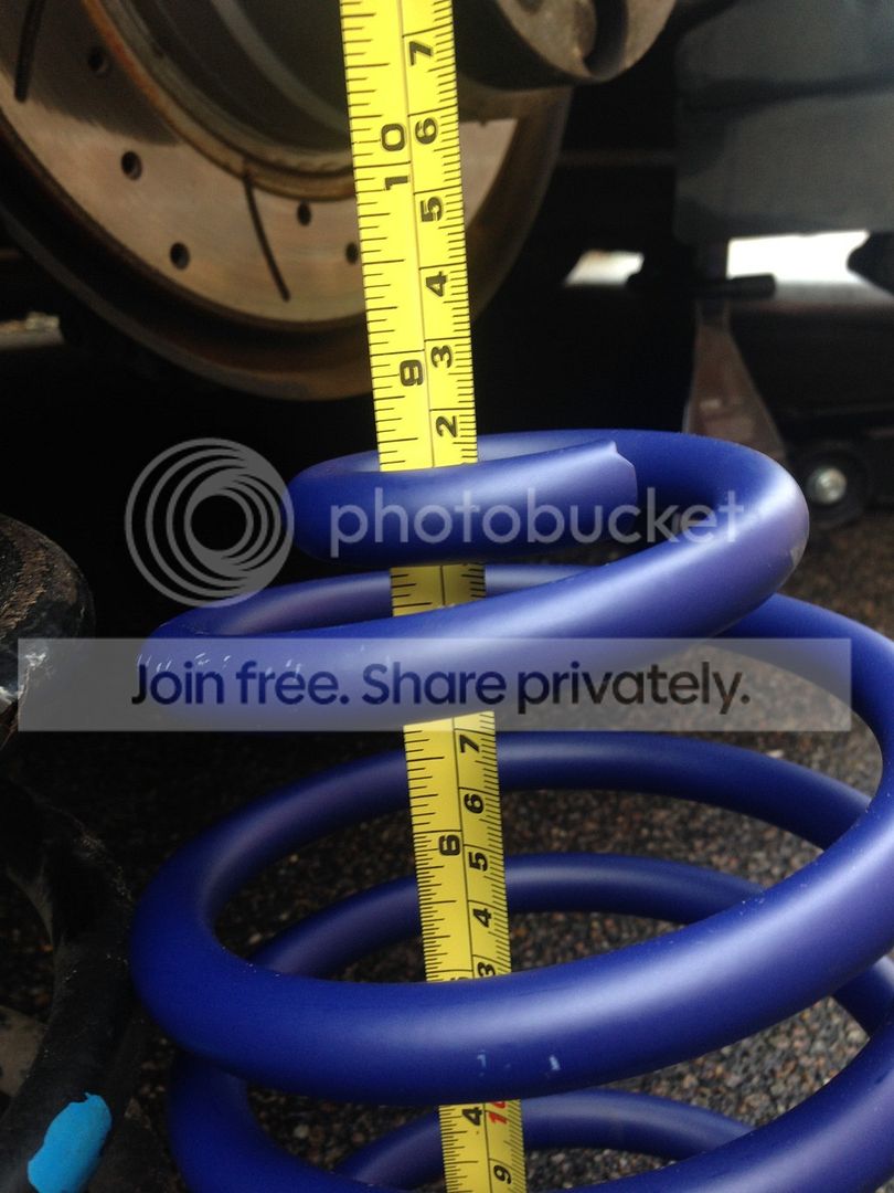

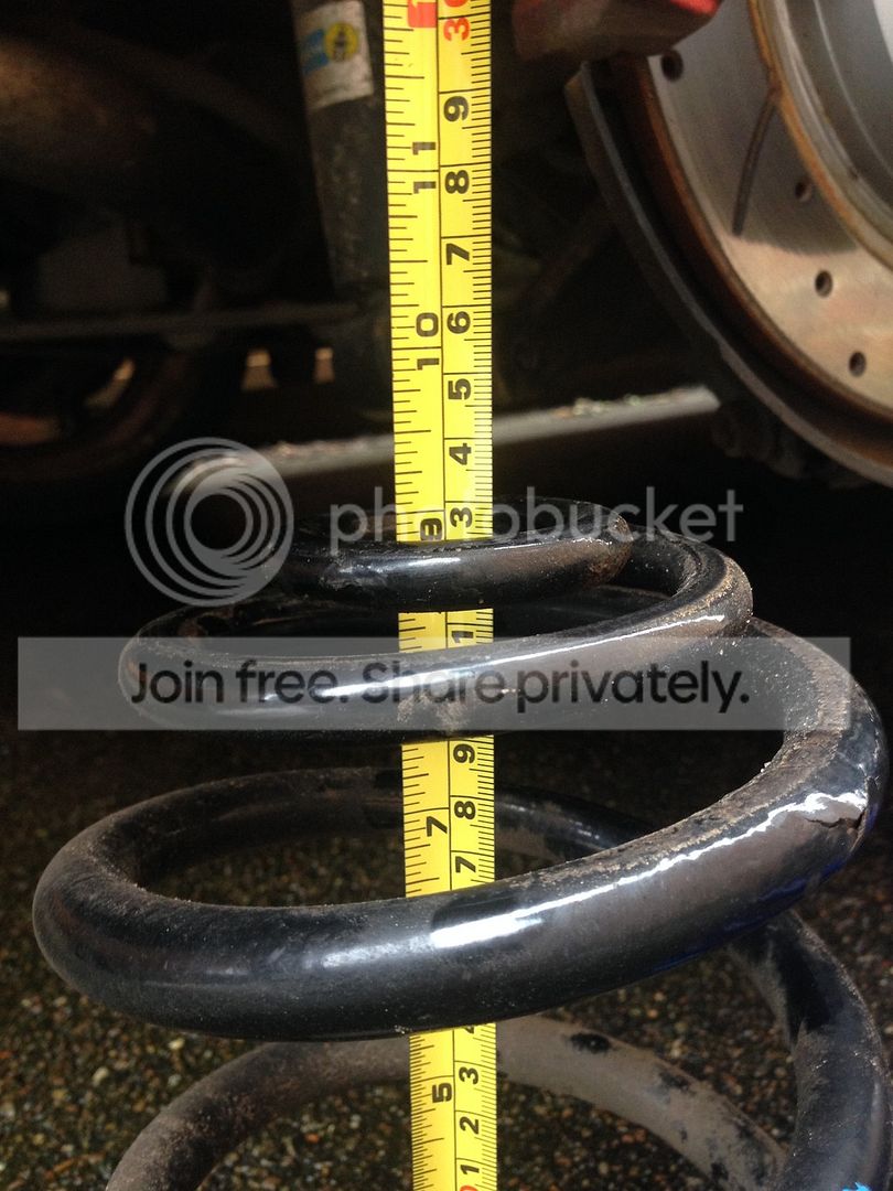

about time i got around to fitting the springs...
1st up the rears as they are easiest!

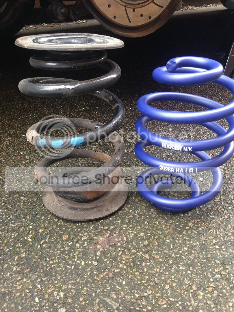

old spring next to new spring:
the 2 next to each other:

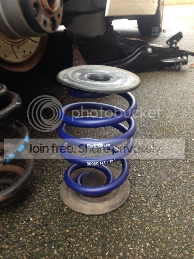

old uncompressed spring height:
new uncompressed spring height:
new spring ready to go on:
new springs on and fitted:

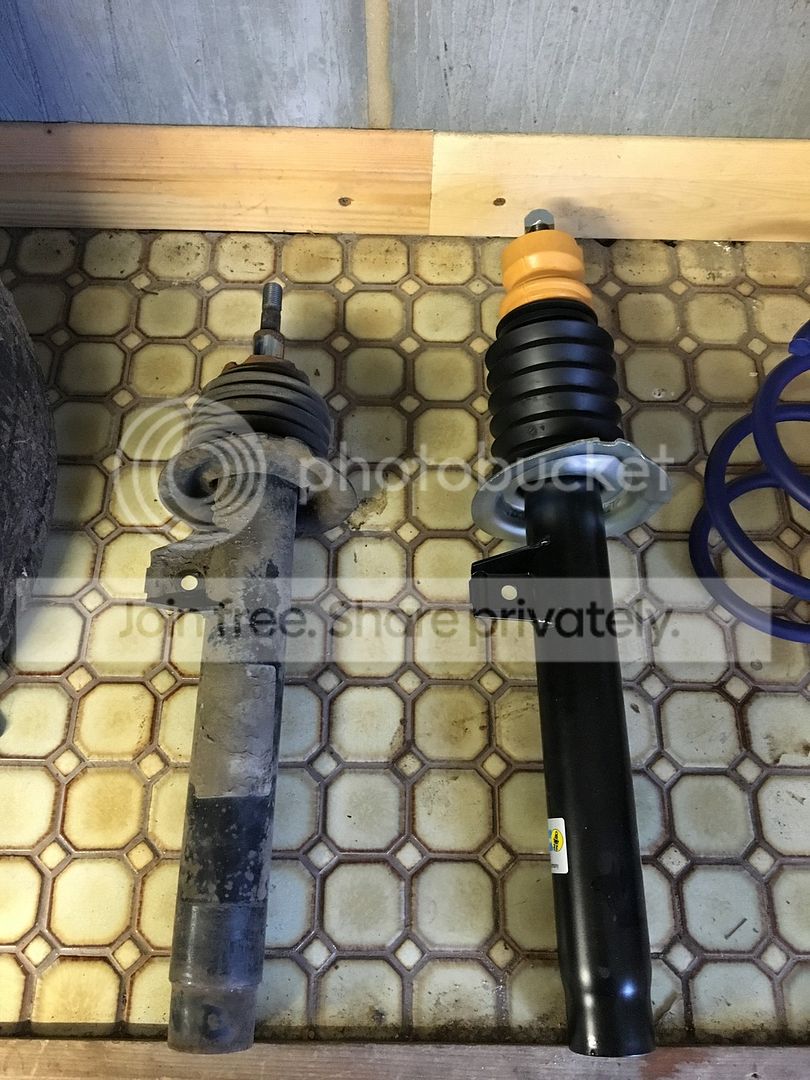

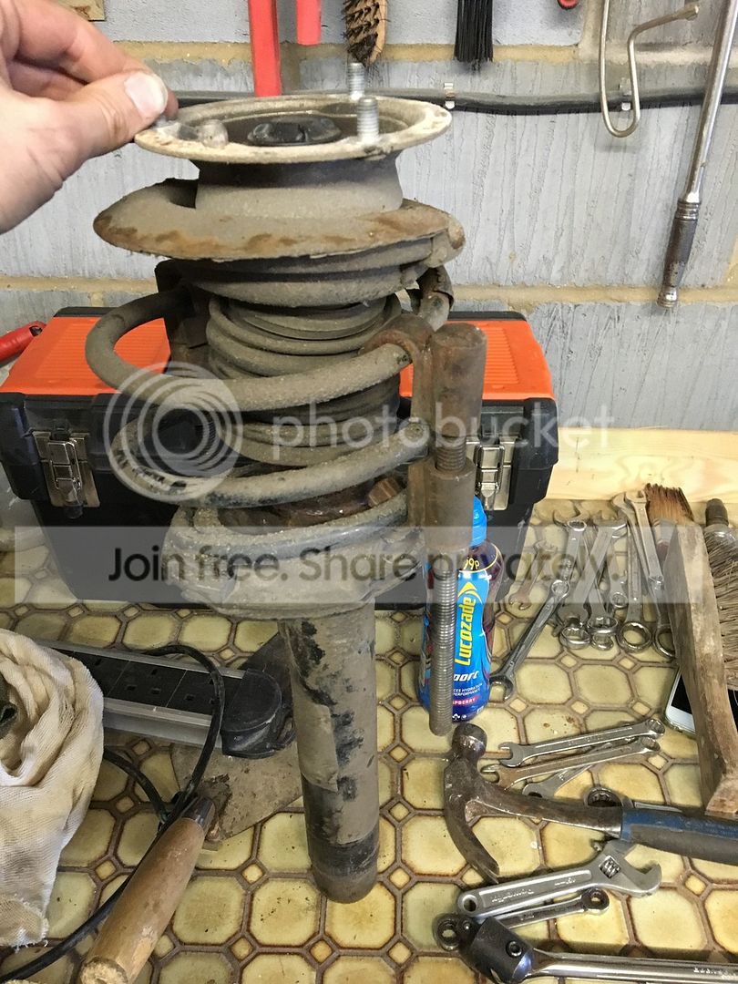

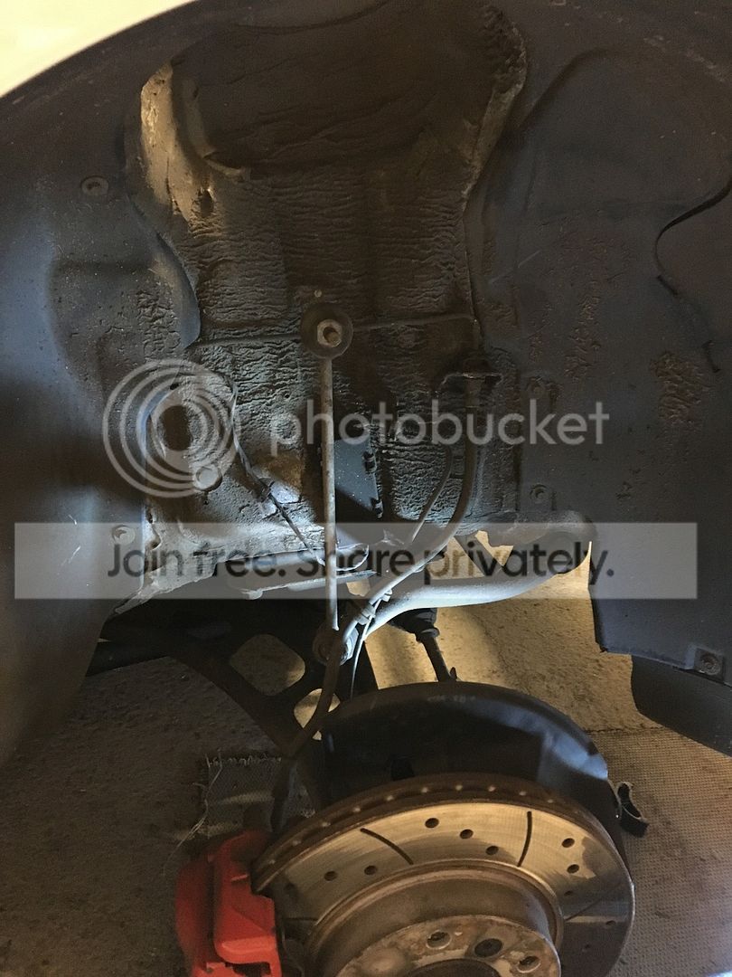

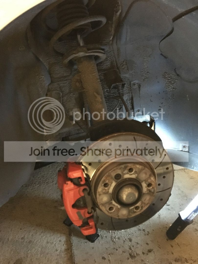

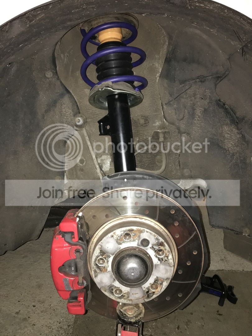

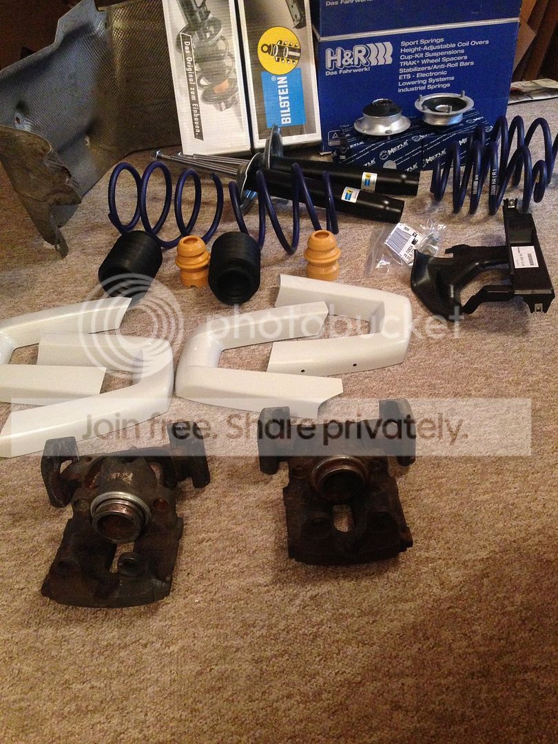

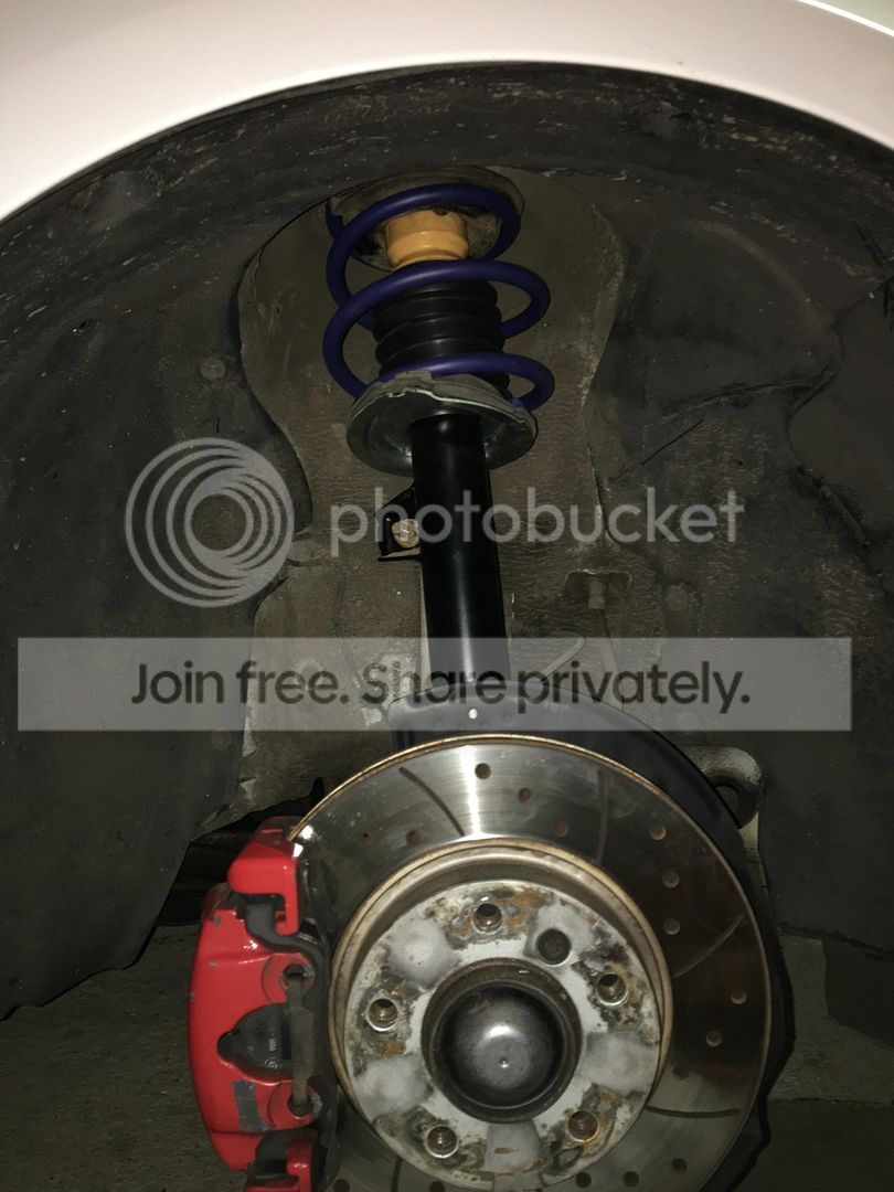

next up, the front springs AND new Bilstein shocks!!!!!
old shocks and springs:
old shock/spring set up removed:
old shock/spring set up ready to be disassembled to reuse rubber pads etc:
old knackered shock next to shiny new shock:
old springs next to new springs:
new shock/spring set up trial fitted:
new shock/spring set up fitted and bolted in:

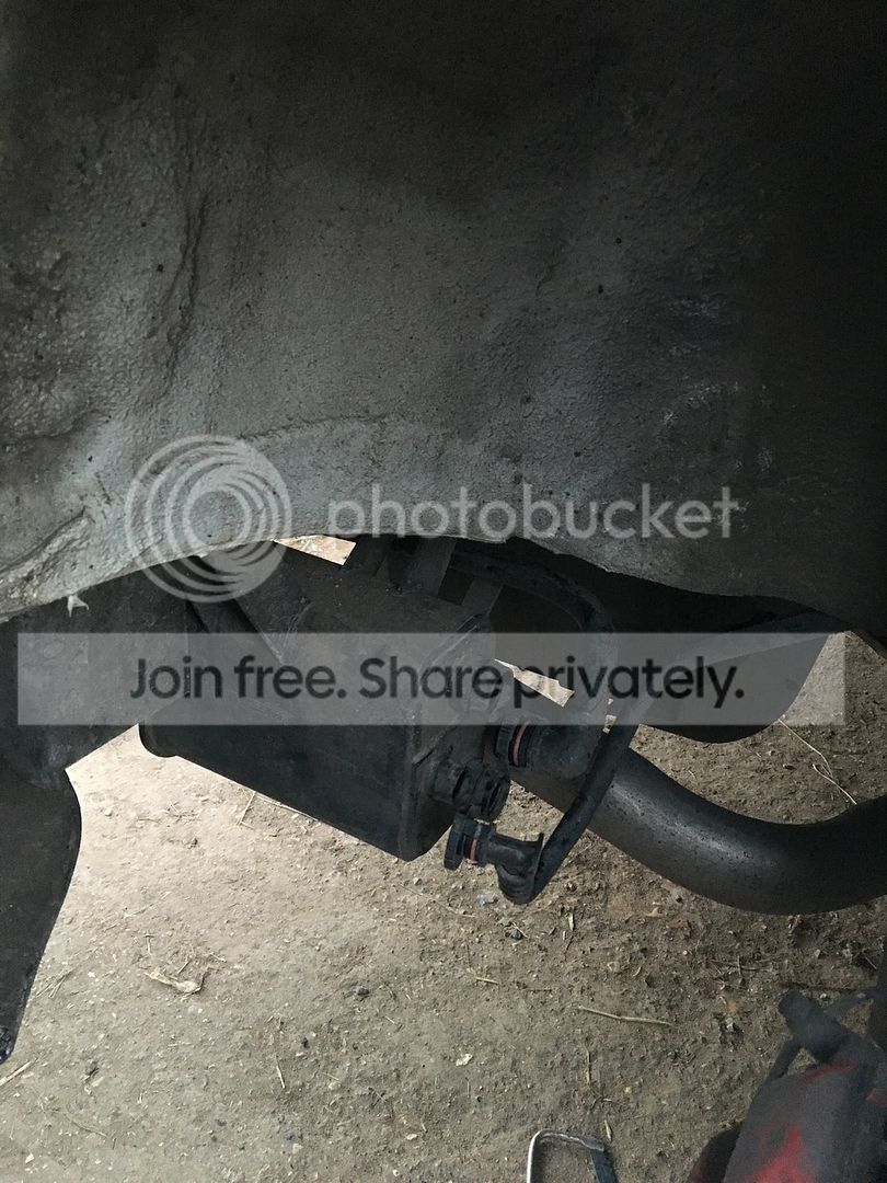

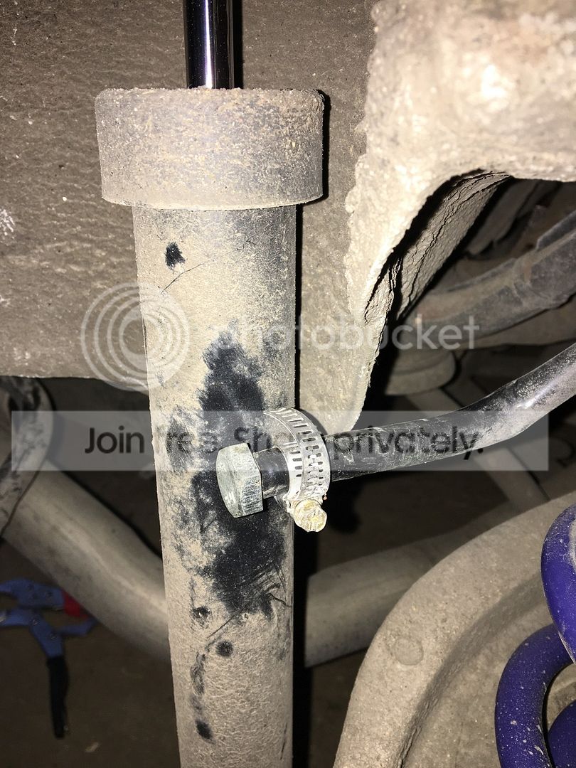

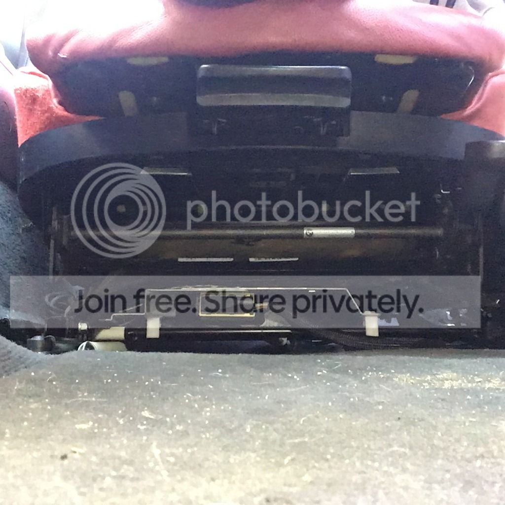

charcoal filter disconnected and then unbolted and removed:
pipes bunged up and jubilee clipped to stop anything getting into the fuel tank:

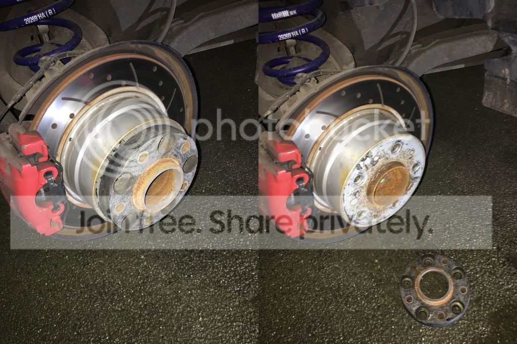

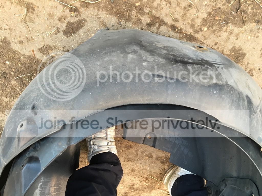

after removing charcoal filter i can remove the spacers and replace the worn wheel arch liner from rubbing
25mm spacers removed:

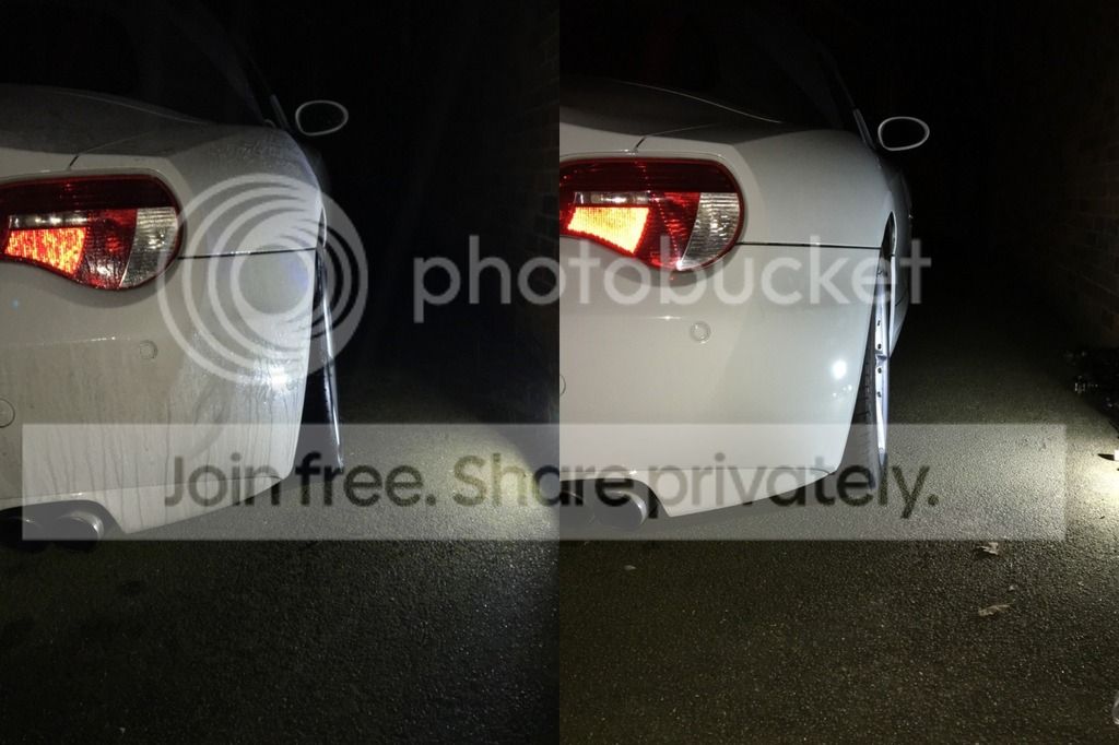

before and after stance:
and damage to wheel arch from rubbing: (new and old)

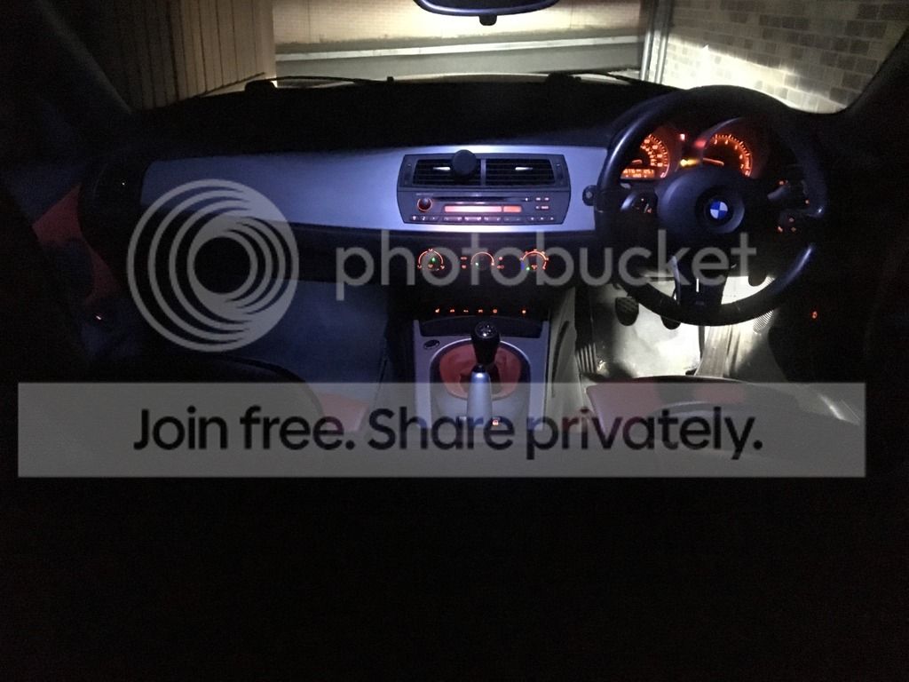

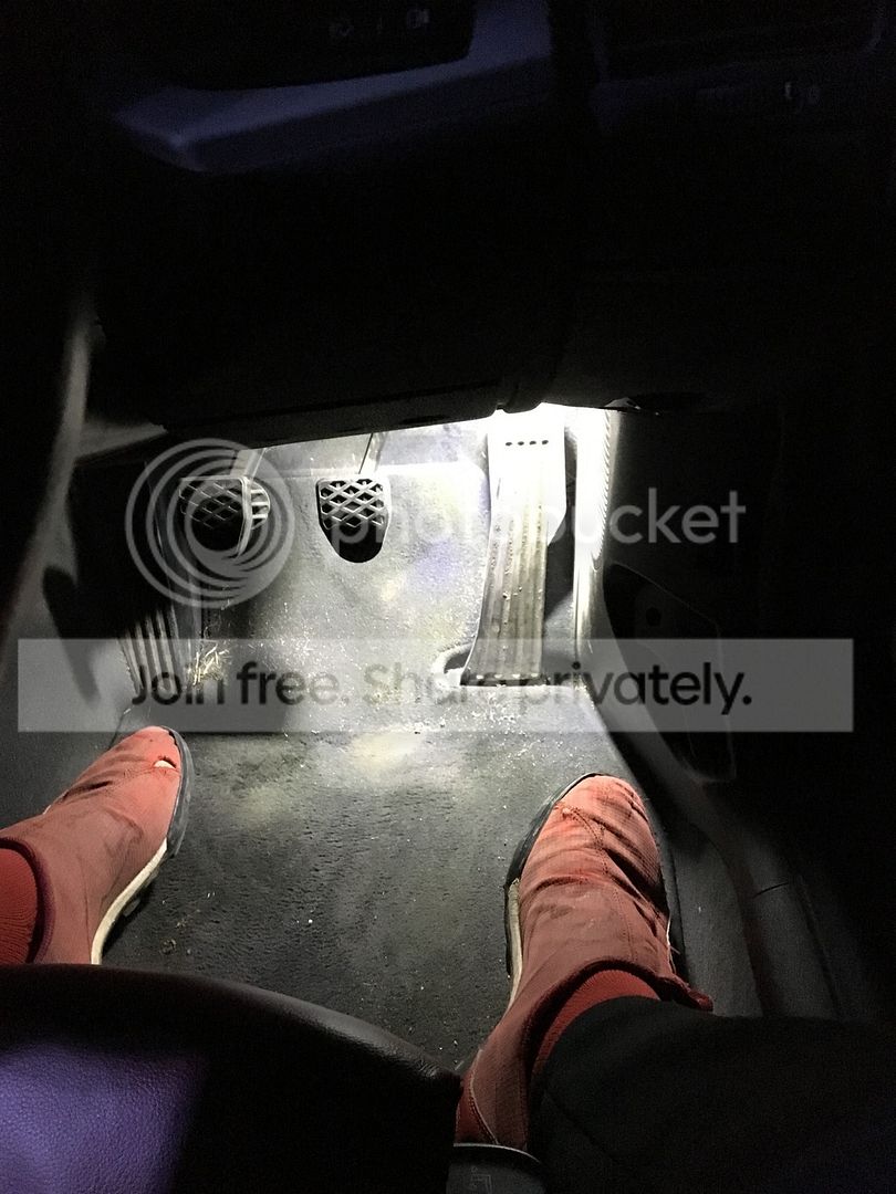

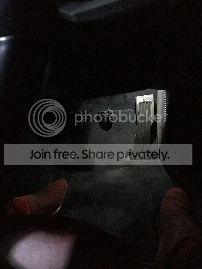

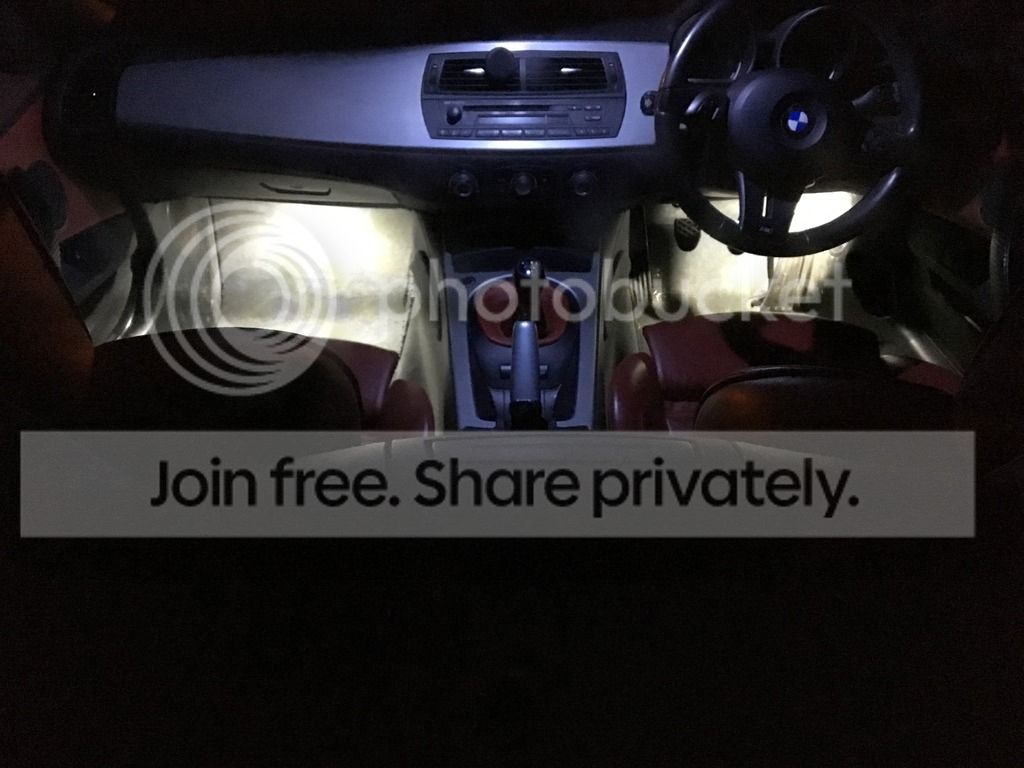

footwell LED light upgarde:
please ignore football boots/trackies as it was a quick job before football.
drivers side before:
drivers side after:
passengers without, drivers side with new LED lights:
both with new LED lights:

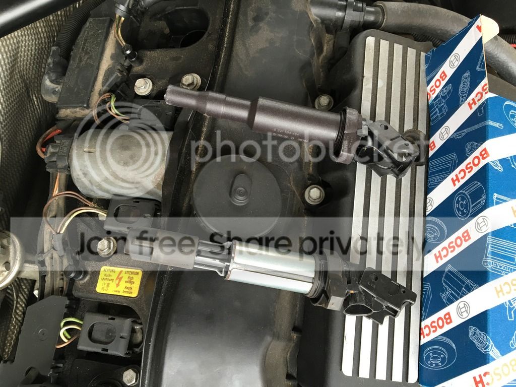

after a misfire on cylinder 4, swapped coil pack to cylinder 3 and error code moved with it so isolated the problem, quick trip to eurocarparts (in a different car) £20 later and i can replace the coilpack

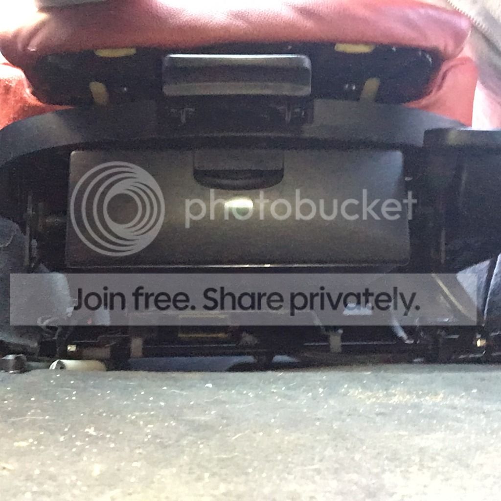

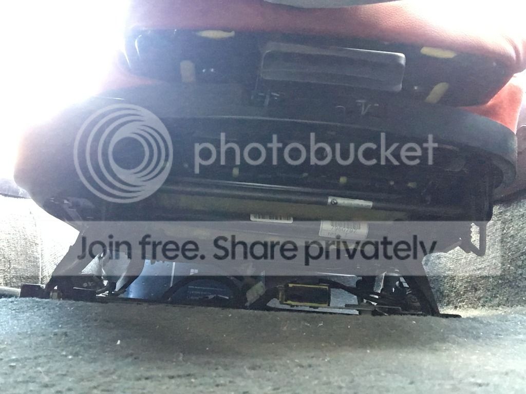

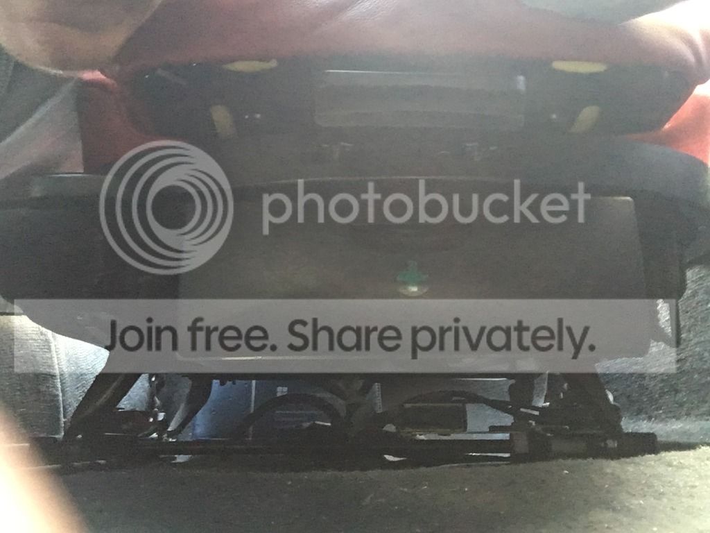

finally got around to fitting the 1st aid boxes, sorry for poor iphone front facing camera photos:
passengers side before:
passengers side fitted:
drivers side fitted:
