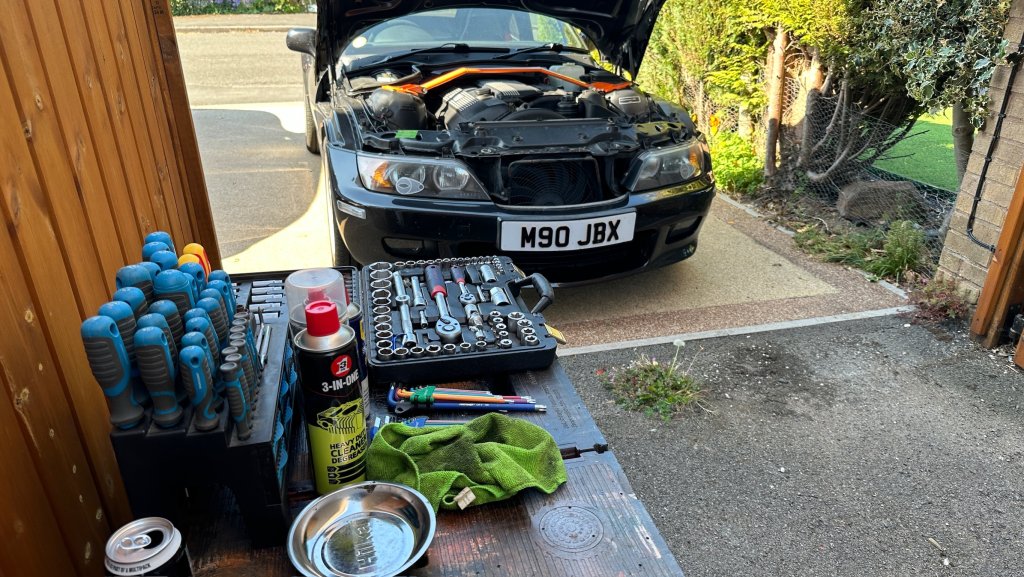

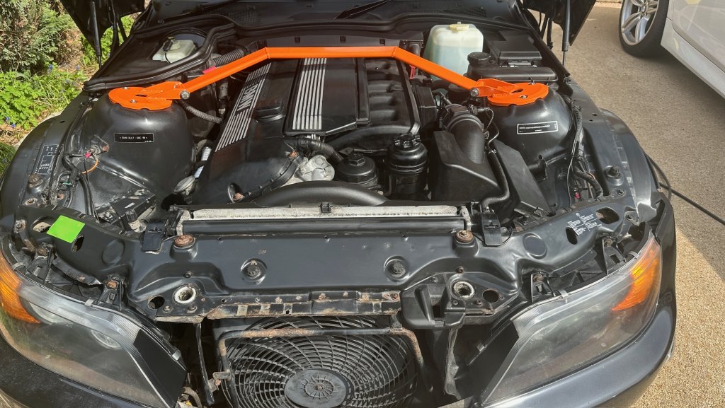

This weekend I replaced the thermostat, water pump, rad hoses and drive belts. It all went pretty smoothly and the temp gauge is now dead centre and the heater is blowing lovely hot air. I just need an excuse now to go for a drive and give it a shake down.
I wasn't able to find the block drain, so only got 5 litres of the old coolant out, so I'll probably change it again next year and give myself a bit more space to properly get under and try to find that pesky drain!

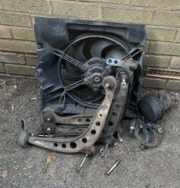

It started off really positively, I went out Friday evening just to get the front of the car on jack-stands, so I could crack straight on with replacing the AC fan on Saturday morning, but I ended up 'just another 5 mins' for about an hour and completed replacing the fan before I came in. I can get it booked in for an AC re-gas now.
Buoyed by that success, on Saturday morning I went about deleting the secondary air pump, and finally fitting the blanking plate @t-tony sent me months ago. Another item ticked off the list.

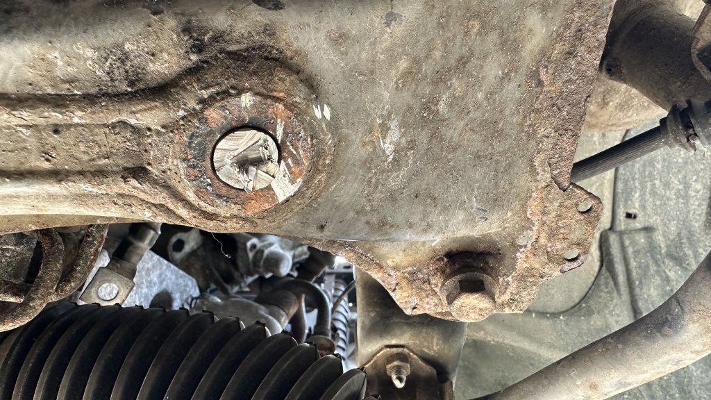

But no, next thing was replacing the lower control arms. I already knew one of the ball joint boots was torn by my own doing last year when I replaced the knuckle, but checking the last MOT advisories (which is due in a few weeks), I remembered that it had advisories for play in the ball joints too, so I thought I'd replace the control arms with the ones I fitted new to my first Z3 last year, that I bought back off the guy who bought what was left of the blue one (still following me?) Anyway, I found that the ball joint covers were torn on those ones now too (again, at least one of them probably by my own doing, I'm guessing there is a knack for using a ball joint splitter without tearing the boots?)! Bugger. I have ordered another pair of arms which should come this week and carried on with removing the old ones...
Offside

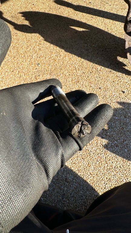

Disassembled the brakes, undid the knuckle ball joint. Started undoing the chassis ball joint when the corrosion on the threads caused it to seize up and the whole ball joint was just spinning. And the hex/torx hole on the top was so corroded, I couldn't get anything into it, nor was there enough space to hammer a spline bit in anyway. However it was loose enough to split the ball joint though, so I did that and then undid the lollipop bush bracket. With that the control arm was just hanging down by the nut on the chassis ball joint, that I still couldn't undo.
I thought I was being clever by angle-grinding through the exposed ball joint stud, the arm would fall off from below, and I could lift the stud and nut out through the top, right? Nah. This is when I discovered the stud is tapered, and now I just cut away any material I could use to hold against the torque of undoing the nut. I was a bit stuck at this point. I grinded out a slot in the bottom of the stud for a flat-head screwdriver, but I couldn't go very deep before I would have been grinding into the subframe, and with the torque of trying to undo the nut, the screwdriver approach wasn't working. I thought I was going to have to find somebody who could come out and tack-weld the bottom of the stud to the subframe, but I thought I'd take a break and switch to the nearside first.

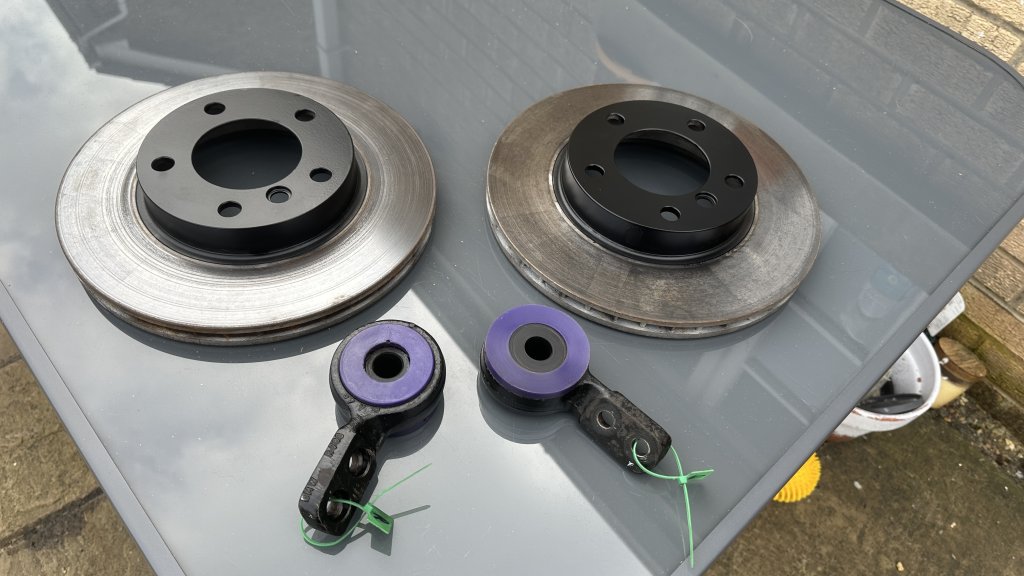

On Sunday morning while I waited for the Amazon delivery, I took the powerflex lollipop bush & brackets off the former-donor arms and cleaned them up, and while the front discs were off, I cleaned up and painted the disc hubs black.

I went back to the offside, there was no ball joint to put the jack on this time, and what was left of the stud went higher into the hole than the lower face of the subframe - if that makes sense, so the jack would have just pressed on the subframe, rather than the stud. I found a nut that was small enough to fit the hole, and a piece of scrap metal to stop it just pressing into the jack pad. I couldn't put enough torque on the nut with a spanner from below, however the jack was holding the stud still, which was a start! By disconnecting the earthing strap and now the secondary air pump was removed, there was just enough room to get a socket and extension onto it and I cracked it from above. I don't think I have ever put so much force onto that wrench, I thought I was going to break something, but I got the nut off and after I removed the jack, a quick tap on the stud with the spanner and it fell out. Second control arm out!
Christ almighty, what an ordeal!
If I ever do control arms again - and I am writing this here to remind myself more than anything - I am going to remove those two ******* nuts before jacking the car up

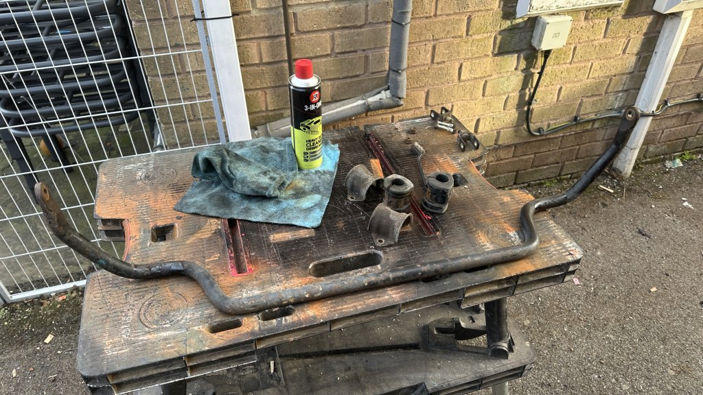

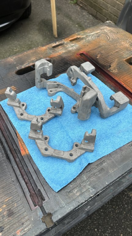

I fitted the replacement control arms one evening last week and got the car mobile again (although missing the front ARB). Meanwhile over the course of the week I hand-sanded the ARB down to bare metal, sand-blasted the brackets and painted it back up again. Rebuilt it with new Delphi drop links and Powerflex bushes.
Much better!
Despite having a nasty cold and feeling pretty rough, I made the most of the weather this weekend by re-fitting the ARB, along with new fuel tank straps (thanks @Mazza) and gave the wheel arches and the inside of the wheels a thorough clean. Finished the weekend off with giving the whole car a wash, clay-bar and polish. Just in time for the rain this week :rolleyes:

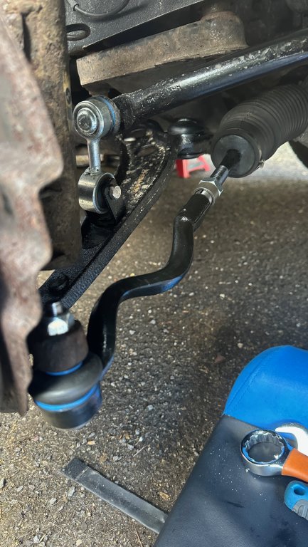

I ordered a replacement pair (Meyle) that arrived on Saturday morning. I've never played with the steering system or track rods before, so I was a little apprehensive, but fitting was surprisingly straight forward and I think I did a pretty good job of setting the tracking 'by eye'. I've got another appointment for the tracking to be done this afternoon, so it should be interesting to see how far out I was!
Edit: Tracking done! One wheel was pretty close, the other was miles off. Sadly no Rain Man-esque natural tracking abilities unearthed this time =)) )

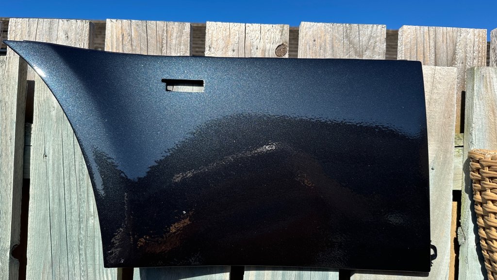

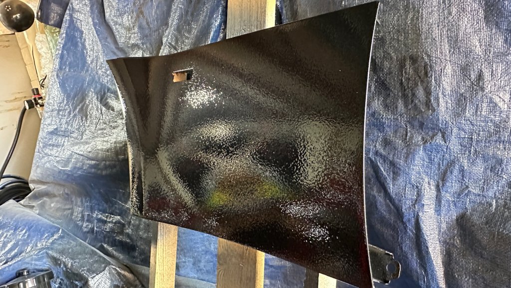

Last weekend I painted up the replacement wing I prepped months ago. I was happy with how the (rattle-can) basecoat went on, however it all fell apart with the clear coat which might as well have been made by Del Monte with the amount of orange peel I got :confused:. I tried to recover it with wet sanding but it wasn't happening, so I took it back down to bare metal and primed it again. This time I have bought proper paint, thinner and clear coat and am going to have a go with the compressor and spray gun this week.

MOT passed! And without any advisories - the last time this car passed first time without any advisories was 2012! I am feeling pretty pleased with myself.

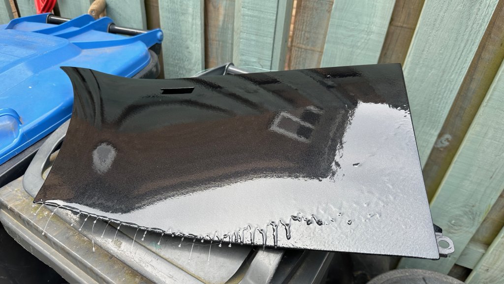

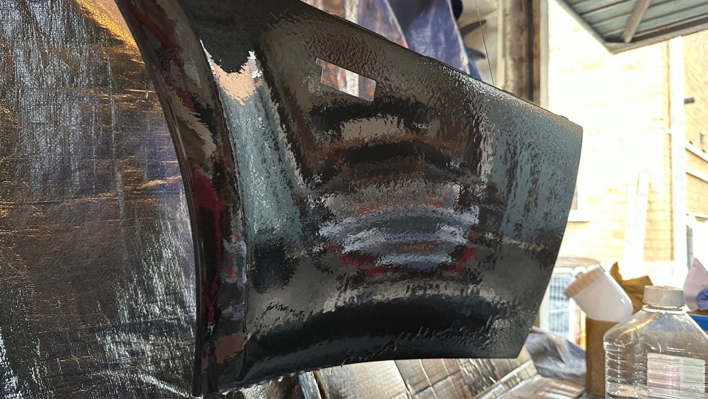

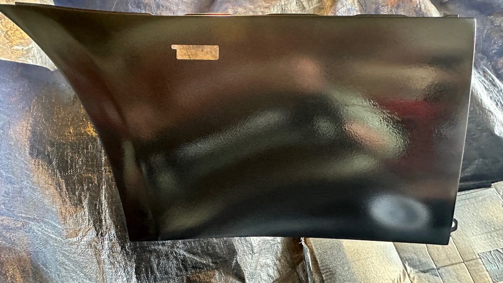

Painting is proving more challenging however. Almost certainly due to using the spray gun that came free with the compressor, and also me having zero experience - obviously.
I wasn't horrified with how the basecoat went on, even if it wasn't a mirror finish, it went on reasonably evenly and smoothly.
However the clearcoat was a disaster. It was coming out of the gun so thick and splattery, that to get full coverage meant it was literally dripping off the bottom edge.
Once dry it looked a bit better, gravity had done a reasonable job at evening it all out - with the exception of enormous runs and lacquer stalactites at the bottom. And a dog hair that found its way into my DIY paint booth (aka dust sheet stapled to the ceiling in the garage).
I left them a few days to fully dry out and then attempted to wet sand them, starting with 1000grit, however before I got close to leveling them out, I had gone through the basecoat and primer on the edge. And so back to square one. I'm going to invest in a better quality gun before the next attempt, and also practice more instead of just jumping in.

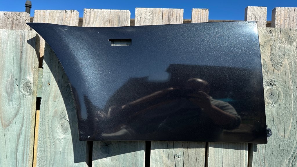

Alongside all this, I resprayed my drivers wing mirror. After the disaster with the clearcoat on the wing, I stuck to a rattle-can lacquer for the mirror and it has come out well, so I am calling that a spray painting success, even if it was only the basecoat that actually got sprayed =)) I just went to get a photo but I only finished it last night and after driving it to and from the test centre today it's dirty already. It does look well though, trust me bro!
