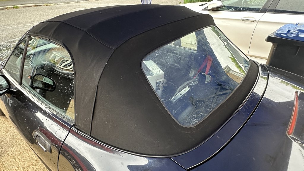

The 2.8 is now fully operational! The slight problem I have now is you wanted to see the new roof - which is attached to the 1.9 and currently SORN (and sans-interior 😅 ) I get back from Cornwall on the weekend of 14th/15th and I'm tentatively planning to attempt the switch then. If it goes well we could do any time after that. Of course if you're ever passing nearby Darley Dale, let me know and you can come and have a look. I'm only 10 mins from the Monsal Trail which I know you like to frequent ;)
You're going to the Thoresby meet on the 29th, right? All being well you'll see the new roof on the 2.8 then if not before.

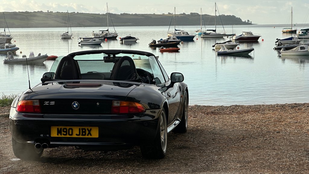

Cornwall trip was a great success.

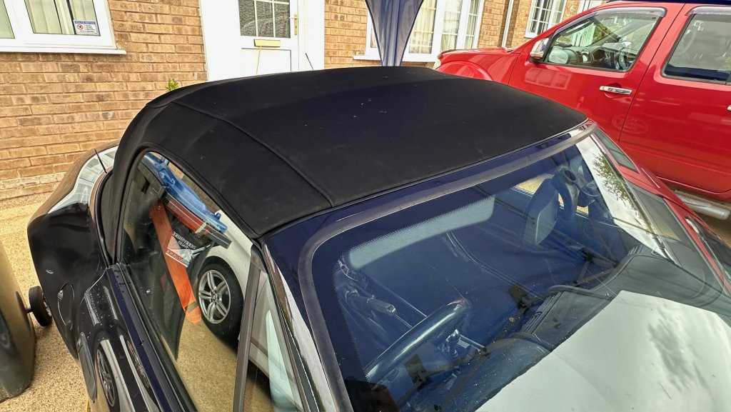

I confirmed what I already knew, which was that the roof seals were knackered. There was a visible gap between two of the pieces on the passenger side, and there has been a tape product applied on the outer edge of some pieces. A shame because the material, frame and window were all really good. Thankfully after a soggy start, the rest of last week was mostly dry.
I know we don't own these cars for the economy, but I was really impressed with this - I managed 30.7mpg on the way down, and I wasn't exactly hanging about 😈 By comparison the same journey I did earlier in the year in the 1.9 it managed high-29s. My gut feeling is that the 6 cylinder is so much torquier that I don't have to wring its neck like I did the 1.9?

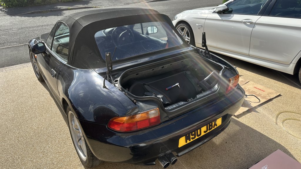

While I was away somebody offered to buy my 1.9 (sans interior and roof), so I had barely finished unpacking on Saturday when I was getting to work taking the roof off my 1.9 and cleaning all the adhesive off the sealing strip before transplanting it onto Izzy. The sealant is still curing and I don't want to speak too soon, but it all went rather smoothly! I was even able to fit the microswitch and replicate the correct wiring route through one of the metal tubes. All fitted up and it works a treat, so I'm really happy.
The eagle-eyed amongst you will spot the dehumidifier in the cab. Unfortunately we did collect a fair amount of dampness in just a few wet days, so while we're due some warm and sunny weather I am going to try and dry it out as best I can and hope I don't need to pull the carpets out like I did my blue one!

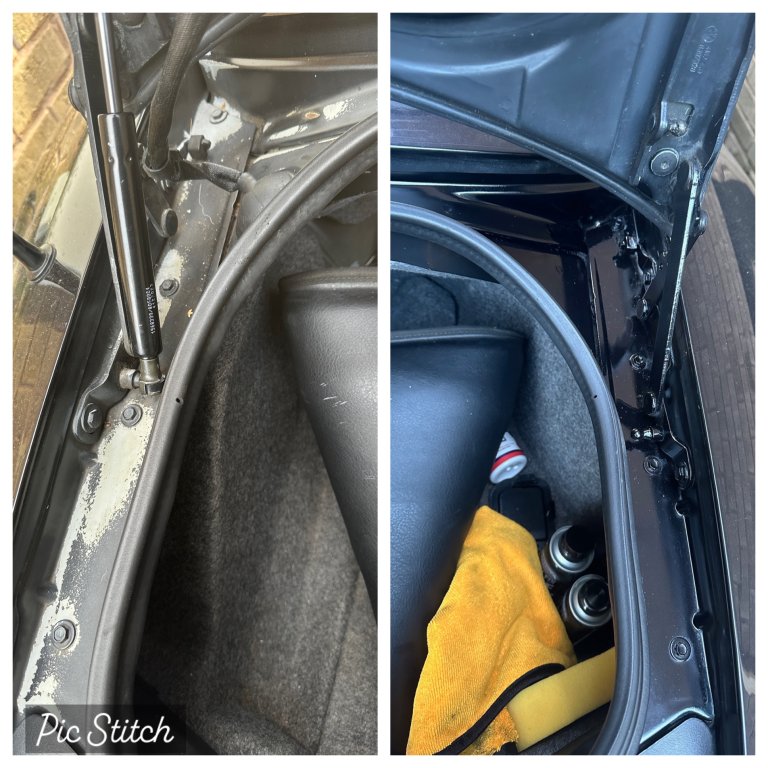

This weekend I also fitted the boot lid I got to replace the one with the holes for the luggage rack. I was pleasantly surprised how easy it was to physically fit the lid. I was expecting to need 5 pairs of hands and cloths and pads to protect the paintwork, but actually with those notches for the upper bolt holes in the hinge, it was easy to just slot those in and then tighten them up, like putting a monitor or TV onto a stand. In hindsight I should have changed the lock while both lids were off the car, but I managed to install the old lock into the new boot lid after it was fitted. Helpfully, the replacement came with the loom and wiring, so I didn't need to mess about transferring those across. However both looms are teetering on the edge of becoming another 'loom of doom', so rather than picking the best one and splicing it in, I have bought another loom repair kit from ebay and will fit that when it comes. In the mean-time I will just go without the centre brake light and central locking.
Not sure if it's related or just a coincidence, but while I was fitting the replacement boot lid, the overall central locking stopped working. I'm hoping that it is just because the boot loom isn't connected, rather than that I have killed something. I did have something similar happen with the blue one when I was working on the car one day with the key in my pocket and somehow it lost its identity and needed to be reprogrammed with the old 'dancing fingers' trick

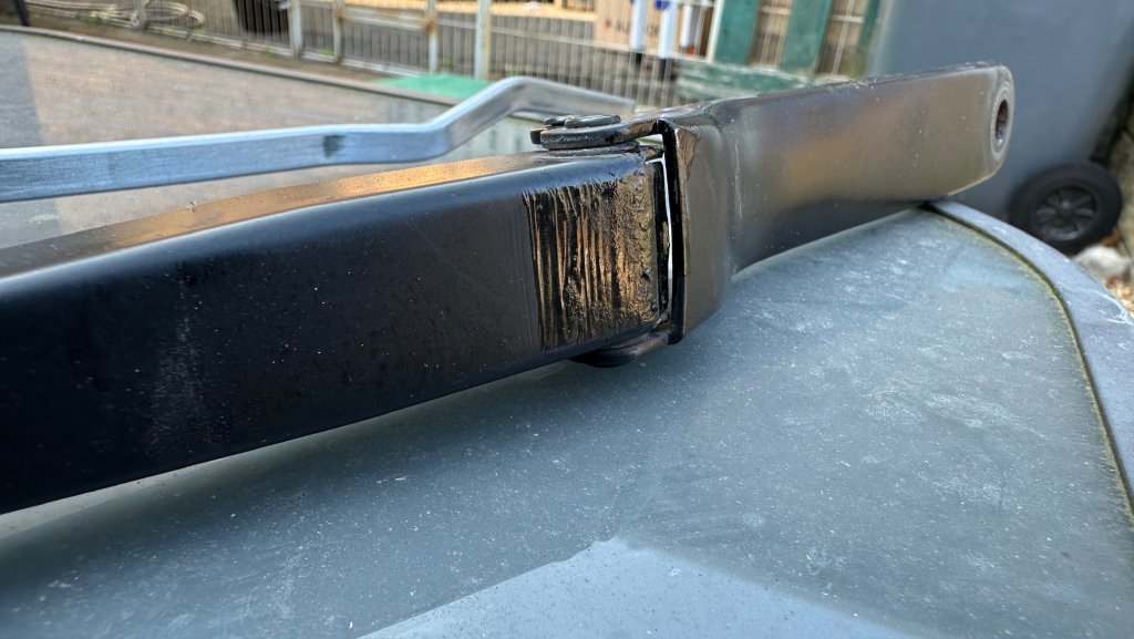

Turning my attention to the front of the car, I removed the wipers so that I could clean out under the scuttle panel. To my amazement I needn't have bothered as it was already spotless under there! :cool: However with the wipers off I wanted to repaint them. I'd already had a go at touching up a few spots while they were on the car, but they came up looking horrendous. Also the drivers' side wiper had been put on the spindle one or two splines too high, and it wiped past the edge of the windscreen and parked too high, so I was able to sort that out when I reinstalled them too.
I sanded them down to bare metal, then used acid etch primer and a random gloss black spray paint I found in the garage since the Hammerite was nowhere to be seen... They've come up really well, a nice little afternoon job all in all.
Botched touch-up
Is it just me or would they look pretty cool chrome plated?
After! (They are spots of rain rather than bubbles or dust in the paint! 😅)

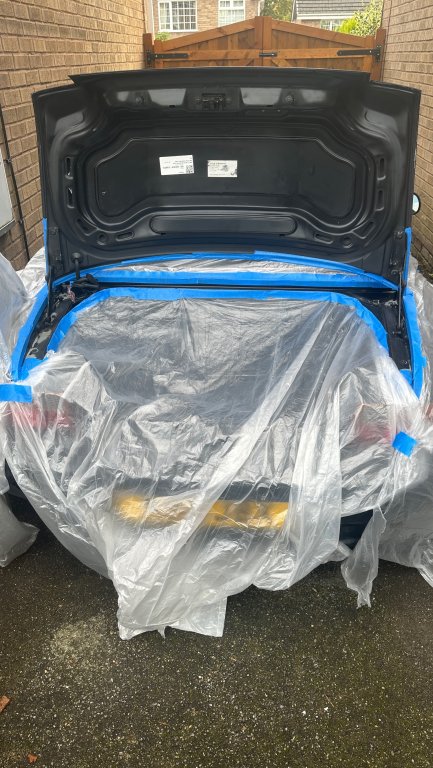

Before I got the compressor, I'd found some rattle cans on ebay that claimed not to require clear-coat, so I thought it was worth a punt. They arrived yesterday so I thought I'd give it a go on a couple of tasks.
The first was the boot lid door jamb, I'm not sure what had happened or whether this is how it came from factory, but the paint was really patchy, to the point where you could actually see the grey (primer!?) between the panel gap when the boot lid was closed. I masked off the bodywork and the boot opening itself, removed the dampers and gave the area a good clean and degrease. I did two coats of this paint and am thrilled how it came out.
I still have the door handle covers that I abandoned when the clear coat failed, so I cleaned them off and though it was worth giving them a blast with this paint. I'm really pleased with how they look. I'll fit them next time Izzy gets a wash

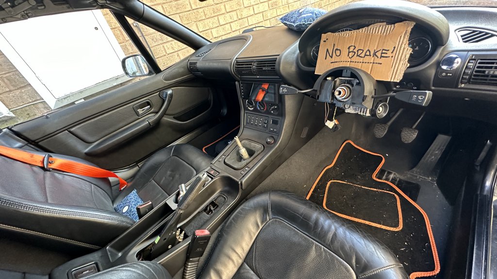

Painting the calipers is nearing completion. Carriers, anti-rattle clips and 16mm bolt-heads are all done. I had to start the front calipers again this weekend though as there were fish eyes coming through. I reckon the microfibre cloth I used might have had some residual WD40 on it :banghead: The sandblaster made light work of removing the new paint. I had them back to bare metal, cleaned (with a new cloth ;)) and ready to start painting again in less than half an hour. I should be able to get the lacquer on today and then give it a few days to harden before I service them and hopefully get them re-fitted this weekend.
In a case of perfect timing, I got my wheel, gaiters and handbrake handle back from Royal Steering Wheels today, which I needed before I could have pulled the car out to re-fit the brakes. I am so pleased with them, I can't wait to get them all re-fitted
