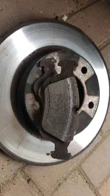

A fairly successful day today sorting the issues out.
Starting at 6.30 I got the drivers seat out to replace the bushes and to add the seat lift mod.
I then replaced the front discs and pads which were in a sorry state. One of the pads appeared to be delaminating!
I then turned my attention to the cooling system. I drained the coolant from the block and radiator, replaced the thermostat and the viscous clutch.
I also competed an oil service and gave it a new air filter.
After filling it up with coolant I took it for a little spin. The car seemed to get up to temperature on the gauge, but there wasn't any hot air from the vents.
Further inspection showed that the thermostat housing is leaking. One to sort tomorrow morning.
