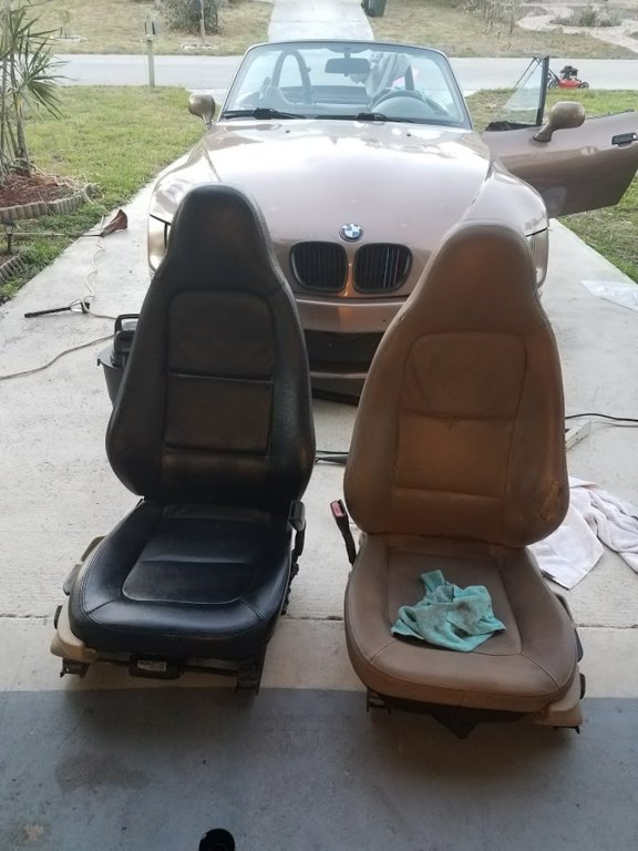

Here she is before I picked her up. This was what enticed me to check the car out. It was a very deceiving picture as the car is/was in a lot worse condition than i thought, but i had already made up my mind I wanted this as a new project car.
I Plastidipped the wheels while changing rotors and pads as well as cleaning and painting all 4 rotors a orange/gold color( I had only painted the rear calipers yet here.) This is also after I repainted the bumpers and side skirt with a 3 gallon compressor/gun combo. Im working on cutting and buffing the paint to shine after learning painting with cheap equipment isnt a good idea. I may plastidip the entire car a satin brown as a cheap alternative because the whole car needs repainting. I also blacked out the bmw roundels for the time being as I would rather spend the money on engine parts but needed to do something to make the car look somewhat presentable.
The Dead Pedal was cracked so i Installed these to mend the issue.
Here you can see on The right the condition of the tan seats so i have mended them as well as redying them to black.

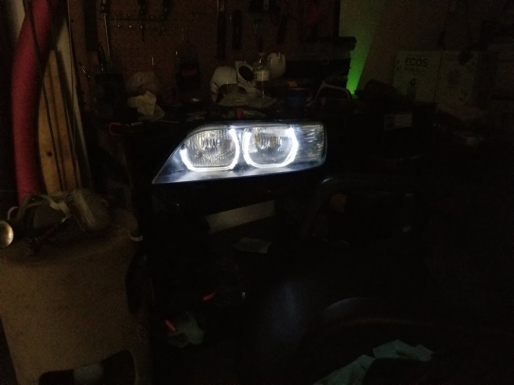

Lastly my attempt at making home made Halos. The headlights had a 100 percent coverage of yellowing over them so I buffed them clear as well.
The Z definitely does not look as nice as a lot of the Zs on here but I have only been at it 4 or 5 months whilst attending University and working at a Veterinary Clinic full time so I have to try balancing my time. It is easy to want to spend all my free time working on the car though my partner does not appreciate me neglecting her human needs.
Edit: I would also like to add that I have mixed feelings on the body kit. At certain angels it looks horrendous and other angles I like it. I love how the stock fenders accentuate the curves and wide stance of the Zs though and when i can afford to buy new panels will probably do so.
