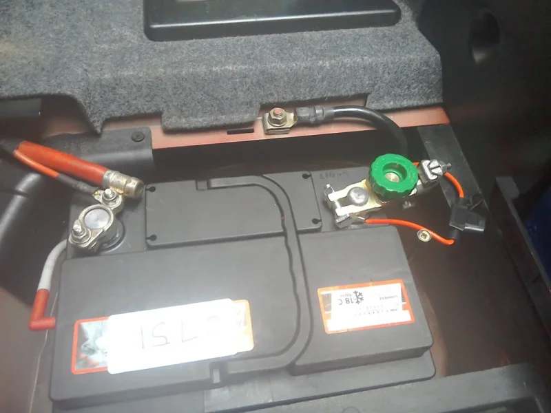

Just changed the battery and fired up first time.
Euro did say it was flat knackered was there words.
I will order the isolator with in line fuse.
See how that works out until I can take another plan of action.
Be nice if I could try an alternator from spurs fan.
Off to order isolator as recommended by Dino.
Tracy.
