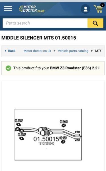

As I understand , The 2.2 and 2.8 are the same…
I bought this online ( less the rear mouting bracket)
The two adjacent middle boxes are definitely cats !!!

Hi Andrew, certainly RealOEM call them Cats too, this is for my 2.2, yours should be the same...
There are also 2 cats in the exhaust manifolds too.

Thank you so much Mint. That’s really helpful. Do you happen to know if it is the same as the 2.8, as someone has suggested?
Sorry, dont think so Malc. The 2.2 are two separate runs from the manifold right to the back box. They don't go into a 'Y' like your photo of your 2.8.
Sorry Andrew, no it's not the same. See post #32 above.
Seems to be only used on the 2.2.

Sorry, dont think so Malc. The 2.2 are two separate runs from the manifold right to the back box. They don't go into a 'Y' like your photo of your 2.8.View attachment 256915
Ooops sorry for the mis-information. Thanks for correcting me ….
