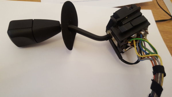

Hi @spurs fan in a coupe. I am in need of a stalk combination switch for my Z3 it has the enhanced clock OBC. I have attached a picture of the old one, it has 2 wires coming out of the stalk by the main switch. The part number is part no 6905025. Thank you for your help

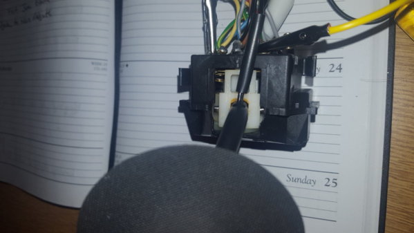

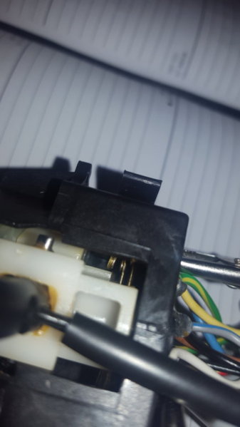

I don't know if this is of any help to anyone but I believe that I have fixed my combination switch.
I connected the main beam contacts (yellow and white wire,pins 4 and 5 on the x32 connector) to a bulb and battery to make it easier to see when the contacts close, and could see that when I pushed the indicator lever up the contacts that close to operate main beam were just touching (they should not be). The contacts are just visible on the LHS of the stalk (see photo). I managed to get a small screwdriver in and push the fixed contact down about 1mm to increase the gap and it now all seems to work as it should
