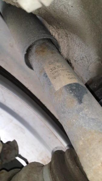

Probably wouldn't help but more likely to be the tyres as the main culprits.I have just noticed that one of the rear shocks make squeaking noise when I push car up and down. Could that be a reason?
Are they the original shocks.I have just noticed that one of the rear shocks make squeaking noise when I push car up and down. Could that be a reason?
It looks like it's sachs, not sure if it's original or or not though ... sorryAre they the original shocks.
Looking at the corrosion in the pic, it could be the original shock, mine were originals (on the car since new) when I took them off and compressed them, they stayed there, didn't extend back out which will affect the way the car drives especially on rough and bumpy roads.It looks like it's sachs, not sure if it's original or or not though ... sorry
That is a factory fitted Sachs/Boge shock absorber.It looks like it's sachs, not sure if it's original or or not though ... sorry
