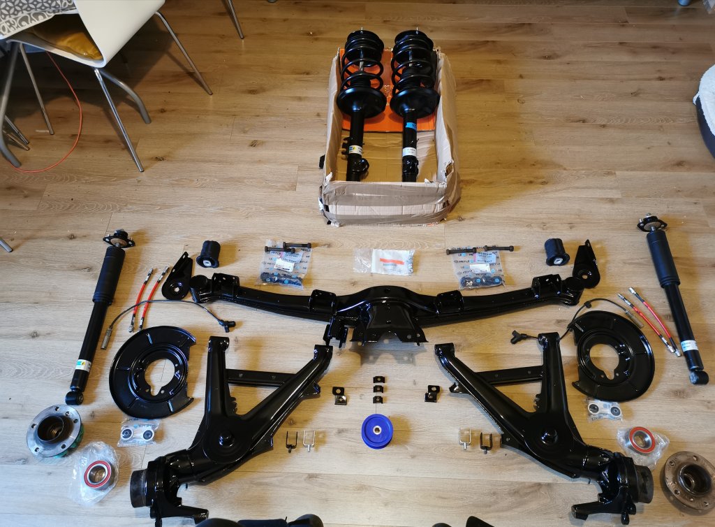

80% of the bits ready for a rear end rebuild with a box coming from Schmiedmann in Denmark shortly with a load of spring pads, nuts, bolts etc.
Parking brake refurb kit, 4x bolts for the chassis plates and some handbrake lines... I think that might be it...🤞
Obligatory bits photo.
Nearly ready! Brake lines and swing arm bushes left.
Look forward to the next steps.
Really looking forward to it but also a bit nervous with rusty bolts. @Stevo7682 has got some special tools for the job, so fingers crossed she doesn't put up a fight.

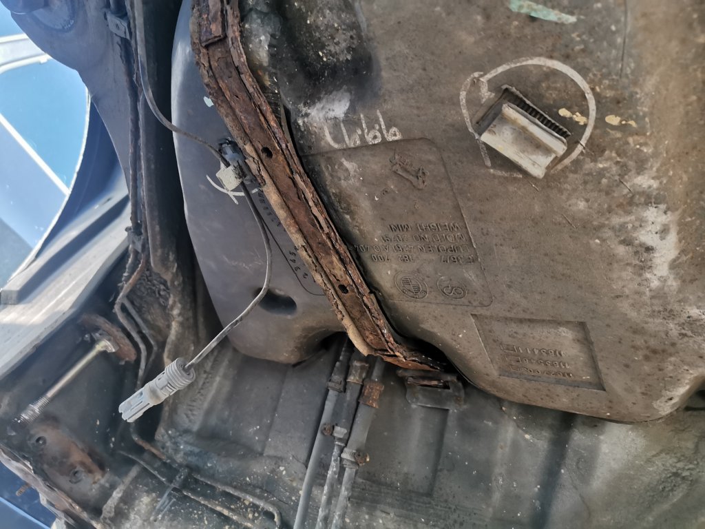

Had it in for a rust check yesterday. Needs por15on the sills and rails behind the front quarter panels. Outer sills are a little spongy in places too. Added to the list.

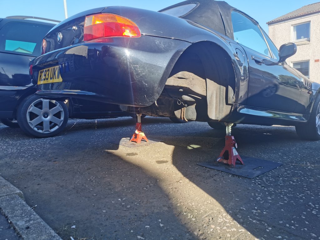

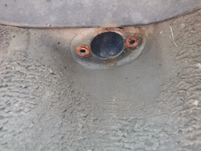

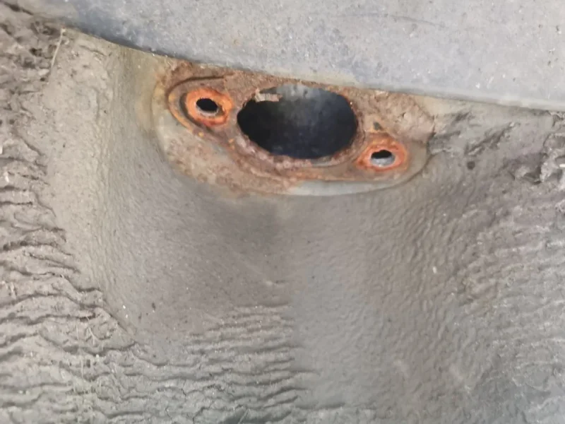

Day 1 of Rear Subframe Build
Super sunny day for it. Scottish skin was burnt to a crisp @Stevo7682 both the brains and brawn of the operation.

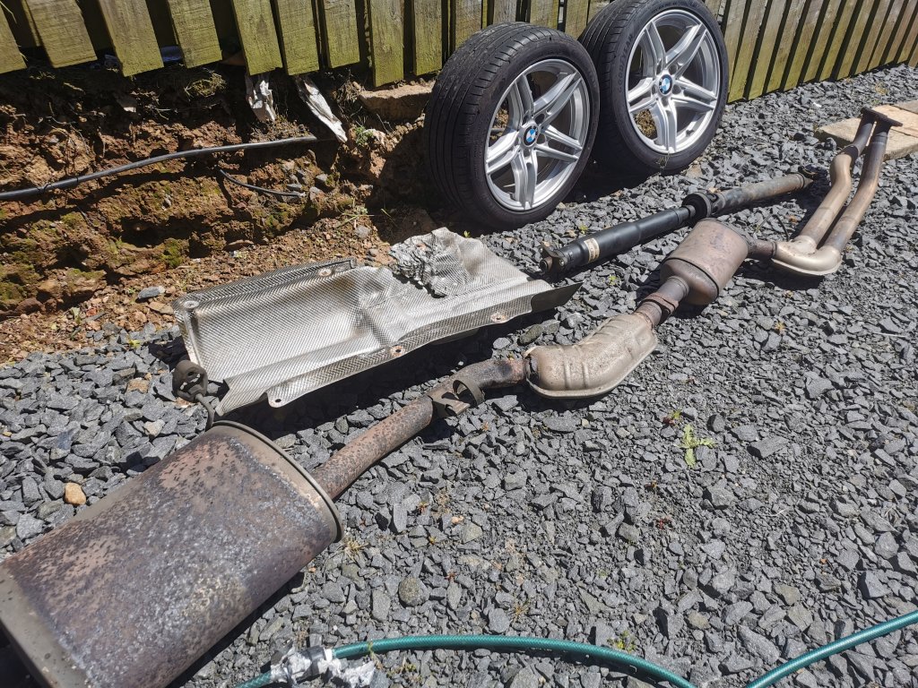

Stage 1. Exhaust, heatshield and propshaft off.
Stage 2. Nuts and bolts - Not an easy job at all when the parts are 25 years old and very rusty. Stevo used his induction coil heater which was an essential tool to get them off as well as knowledge, patience and experience working on cars.
Stage 3. Slowly slowly with the Jacks under the diff and beam. Some gentle persuasion and the beam was out. Around 3 hours to get this stage.

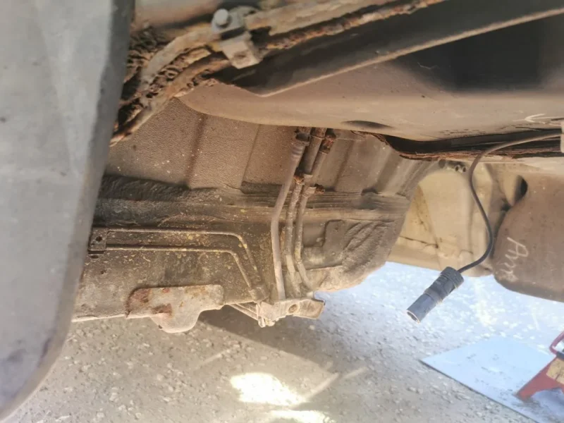

Stage 4. Breakdown some of the beam to get items that will be reused with the refreshed and new parts.

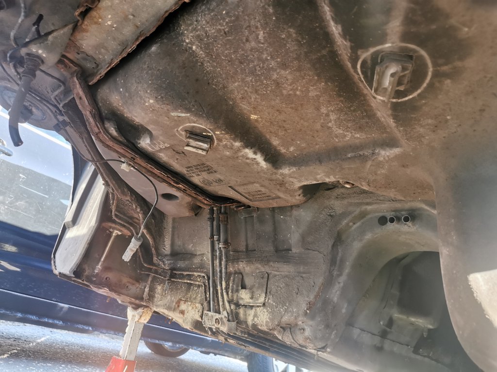

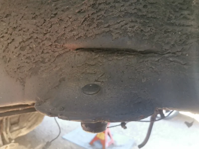

As she sits now and some overall condition pictures.
This side not looking so great. Drivers side seems to be more rusty than the passengers side.
Tomorrow will be some cleansing, rust proofing of some key areas, some issue fixing and hopefully getting the fully rebuilt subframe back in position and back on its wheels. Fingers crossed.

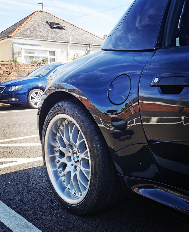

On the fun side of things, a test fit of the 17x9j et26 'style 42' wheel was done today. A scrap 245/40/17 was used to offer it up and see how it fits. The wheel sits in arch without issue but a 255/40 might be pushing it.
Will need to pay close attention to some sectional widths of tyres before thinking about pulling the trigger on 2 tyres that might not fit.
Pleased with the 'dish' levels.
From the top, the 245 didn't pertrude the arch at all. Slight gentle roll on the tyre sidewall but not much.
Last month I bought X4 z3 bbs style 42s, 7.5j and 8.5j rims. All running straight and true but very much in need of refurb before getting wrapped in rubber.
The search still continues for another 17x9j. It's a very rare wheel indeed. 5 down 1 to go.

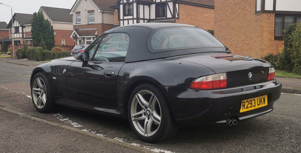

Happy 25th birthday to my Z3 this month. Further trinkets for presents.
5000k Headlight bulbs and 6000k LED sidelights. Makes the car more 'modern'. The 3000k halogen bulbs with yellow tinge dates the car. Subtle upgrade/not so subtle
Period correct headlights also installed. I had been seeking the non chrome trim versions for quite some time and very very pleased with the combo. Excuse my mug in the reflection.

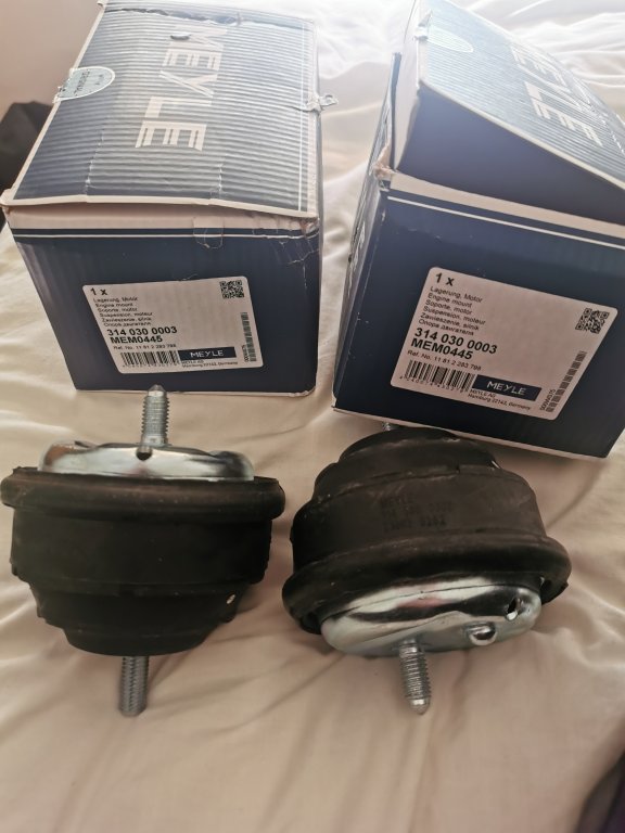

Parts update:
@ZEDonist UK power steering return pipe arrived on Sunday. Looks very nice in black. Meyle Engine mounts x2 arrived earlier in the week too.

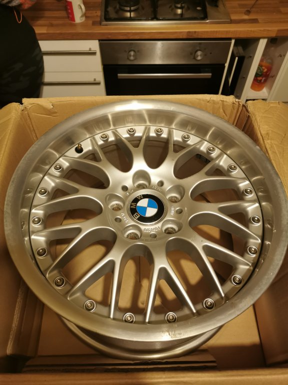

It's taken 15 months but finally I have a pair of 17x9 BBS RS 'Style 42'.
Huge thanks to @DomiMik for being the German interpreter for this international trade.
I pestered him for about a year to message random people on Polish and German marketplace looking to broker a deal. Much appreciated!
