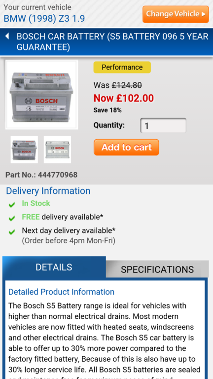

Geoff, check the Warrenty mate as some battery's have a free replacement if they go belly up under a certain time. Could save you a shed load of money as they are not cheap.

Geoff, very FEW batteries only have a 1yr. guarantee most have at least a 2 yr. They go up to 3 and 4 years. Find your receipt out it should tell you on there by law!
