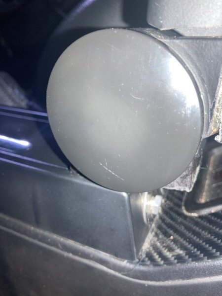

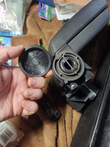

I did this mod a few years ago as well but had a different cup holder I mounted the armrest in. The armrest has an ugly spring on show either side. I bought 2 black plastic centre hub caps for an X type jaguar filed the mounting lugs off and hot glued them over the springs, perfect size and gives it a better appearance. You may of course have a solution already. I can upload a picture if you would like to see.

Got some coming set of 4 so I will have two spare if any one would like some be about £5 inc post

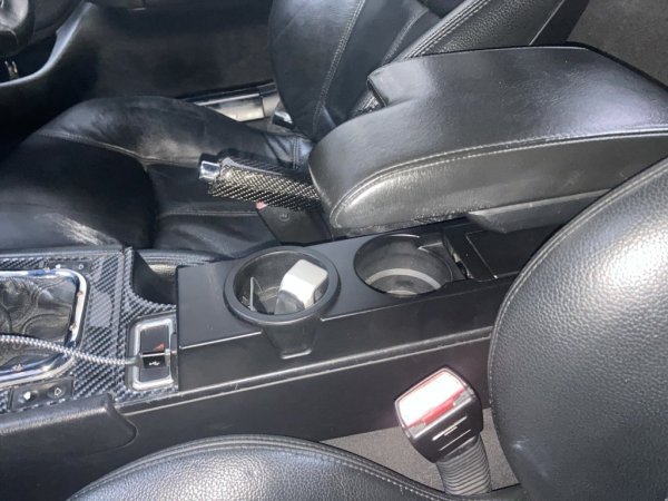

Ok - went for it with a LHD.
So far so good. I made it higher than Sean not to interfere with my handbrake and will now try with silicone as did not want to dismantle the console. Hope it holds my light elbow.
Note that it is artwork to get the angles and corners right. Hacksaw and dremel.
Note that for a RHD the dimensions are mirror image - but should be the same. (The 5.0cm dimension would be a better fit if it’s a bit bigger about 5.2. Basically work down to the dimensions in the images until the fit is snug. The notch in the rear is important for 2 reasons: to provide another ledge for adhesion and to enable the easy removal of the handbrake boot)
Note that had to tighten up the handbrake cables so when pulled up it didn’t reach the armrest.
This is my daily (453,000km) and this has been the best upgrade by a mile. Worth the (mediocre) effort.

I used the Dutch Super7. Looks good.
I’m waiting 48 hours before I put it under stress. 36h so far 😏
(I’m confident in will be ok over the winter. The question is what’ll happen in our summer heat).
If one has able hands it’s definitely worth the effort. IMO puts the interior in a different league. This is a super option if you don’t want a z3 cup holder. If you have one, there is much simpler solution. Just buy a replacement e46 top armrest (a few bob on aliexpress), remove the two ears and silicone a plastic hinge to the back of the cup holder.
This was going to be my route as I already have a cupholder but I can’t find a RHD armrest top so think I’ll have to go the hard way? 🤷‍♂️🫣

If you have a cup holder and want the simple way - Aliexpress have replacement e46 tops which you can rework by simply cutting off the “ears”
(But it’s not as good as the rework of the OEM e46)
