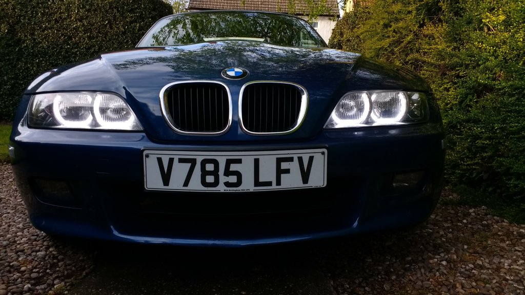

That looks great Bryan. They are really nice units aren't they?
They are Tony. The pic doesn't do them justice, I had to lower the exposure to capture the effect in daylight.
Martin called here a few weeks ago now to ask for opinion on these and I had to say they were Brilliant in all senses of the word. Also his steering pipe replacement is a quality piece of gear.

They look really smart!!!
Did you decide to install them in front or behind the frosted lenses?
Thanks Martin. Behind the lens :thumbsup: best way IMO. Just hope it doesn't affect the beam pattern come MOT time.

I think that is the cleanest look.
Do you know when your MOT is due?
October, but may get them checked before then as the tester is a good friend of mine.

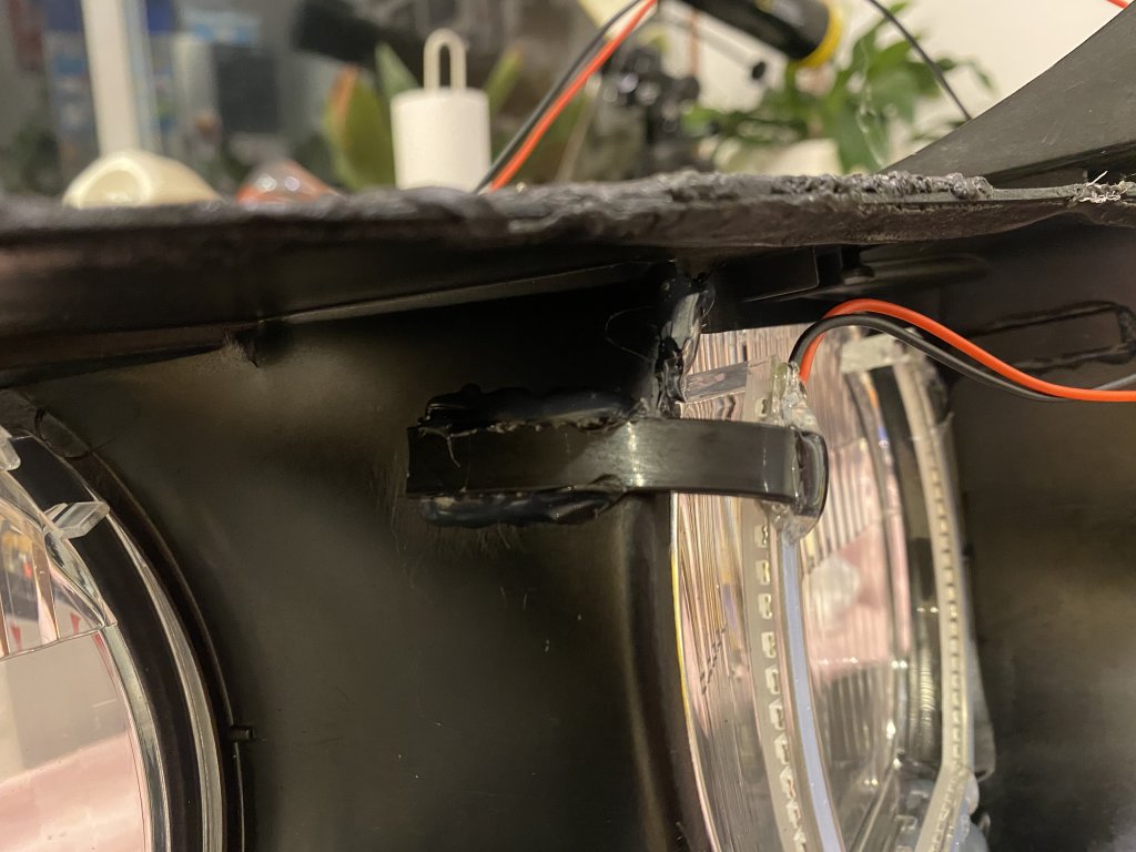

Hi @bertiejaffa
I’ve just seen this message too. I’ve responded to your PM already.
I personally think the best way is to mount the LED halos behind the frosted lenses. I think it is slightly easier as all your work is hidden and you maintain an almost totally OEM look.
I used a hot glue gun and put a bead of glue at the base of the lens. I then sat the halo into this bead and built it up with additional glue.
The halo is pretty solid at this stage but I chose to add an extra bit of strength at the top (as seen in the photos). This is an off cut of stiff cable tie. It’s enough to add support and minimise vibration.
Make sure you etch the headlights black plastic housing before glueing to offer a better key.
Ive done 1200miles around the back roads and mine are solid.
