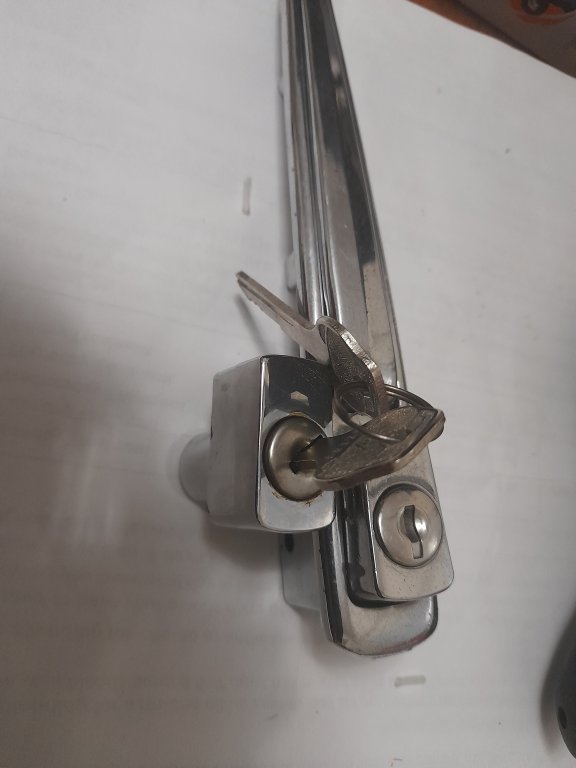

I've 3D printed a rubber gasket. 1.2mm thick, it just sits around the edge of the handle. I know that there are others made from moulded rubber which probably form a small cup that the handle sits inside of. I could have a go at doing something similar but 3D printed rubber gaskets can get a bit messy on their top surface which is why I like to keep them underneath. Maybe I could send one to @Duncodin for comparison purposes?
Another consideration is that the gasket looks like it might interfere with the handle's hinge pin. If so I can slim the gasket a bit or maybe trim a small section around where the head of the hinge protrudes.
I think it might be useful to put a couple of uprisers into areas where there aren't any moving parts, just to keep everything tucked under the rim of the handle. I'm thinking at either end of the handle and at the point between the hinge and the push button well.
I'd be interesting to see the shape of the original... Any photo's available?
Ian, let me know if you'd like to review the gasket, I can send you a handle base too. I've ordered some more of everything in what I hope to be the final iteration so it's back to the waiting game...

You have the original handle I sent to you so can see where that cross piece sits.
I don't think I can review the fit. I'd say you're far better than I am and you've got a door to check it on.

That photo helps 👍. Mine is a bit two dimensional at the moment.
I'll work on getting a bit closer to the original concept, thanks
