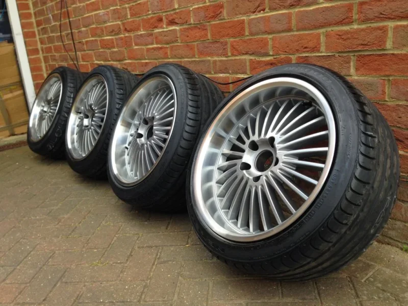

1. Summer:18" Staggered Beyern Multi (18x8.5, 18x9.5) with Nexen N8000 XL all round (225/40/18 and 255/35/18) SOLD

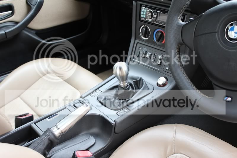

Storm Motorwerks V1 stainless short and weighted gear knob and handbrake cover
Storm Motorwerks cigar lighter blank

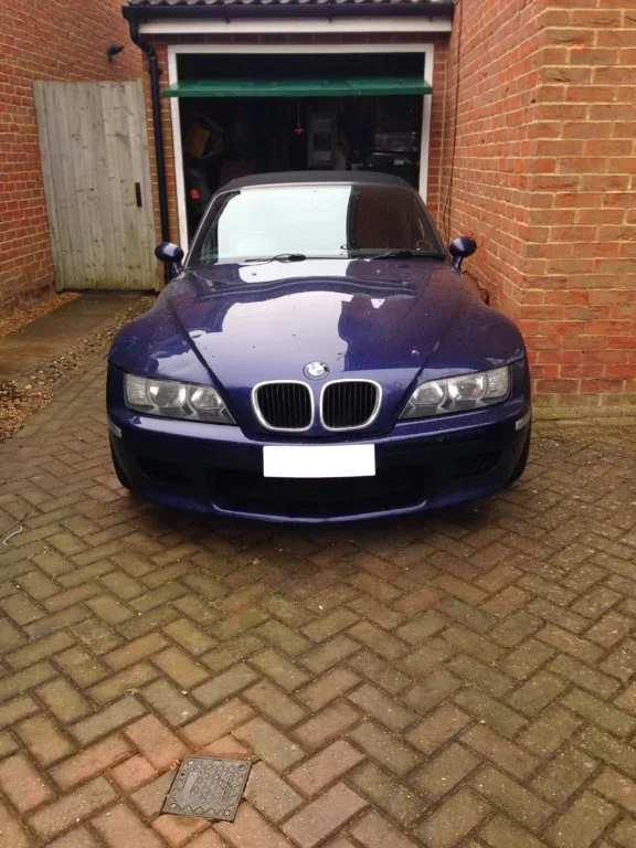

How it looked the day I collected from the previous owner @pangsterZ3 in Edinburgh OCT 2011:

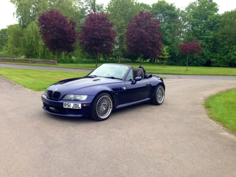

2016 summer:
Winter wheels look with style 78's
Current look April 17 with full respray, custom panel smoothing, shadow chrome M style wheels

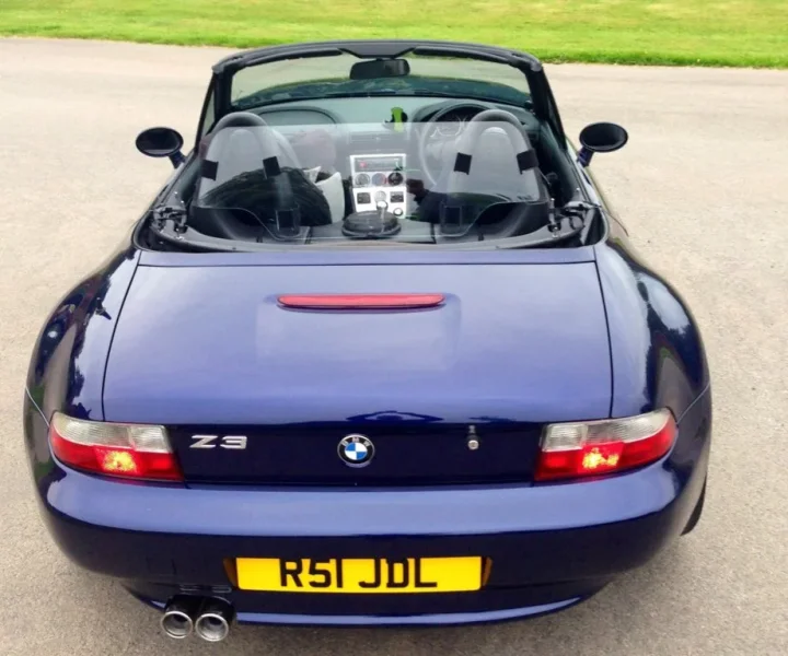

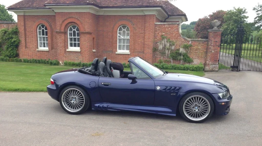

Pics from the for sale ad:

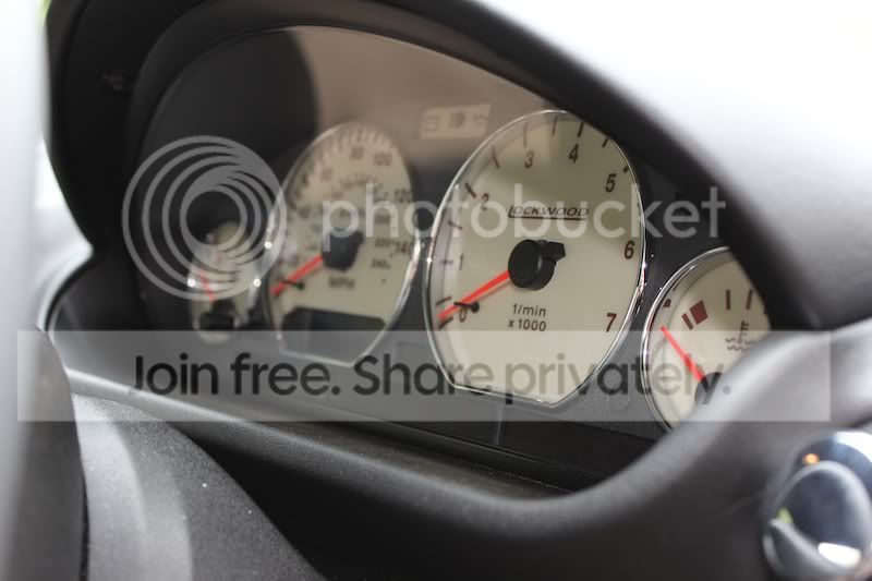

Lockwood dials which have since been replaced by standard after the black interior was fitted.

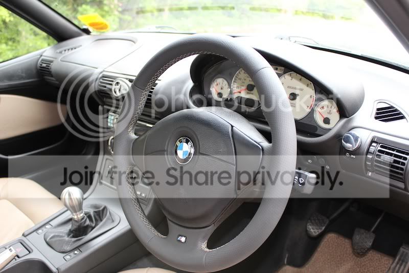

Black sports seats, door cards and facelift console in:
Now with Sparcos (heated) and Raid steering wheel - 2017

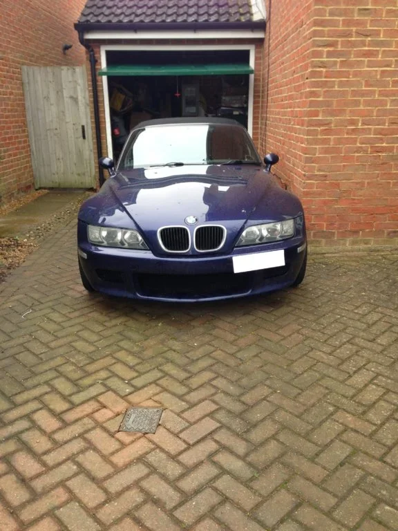

Some pics of it is sad state, rear sunken, rims looking worse for wear:

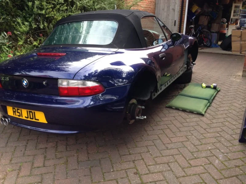

Before anything gets tweaked its up on the axle stands & wheels off for the obligatory inspection.
Wheels off, and mahoosive wheels they are too...
Don't fancy being the one to clean them, even though they are rather nice :joyful:

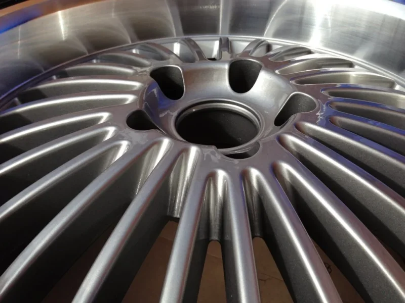

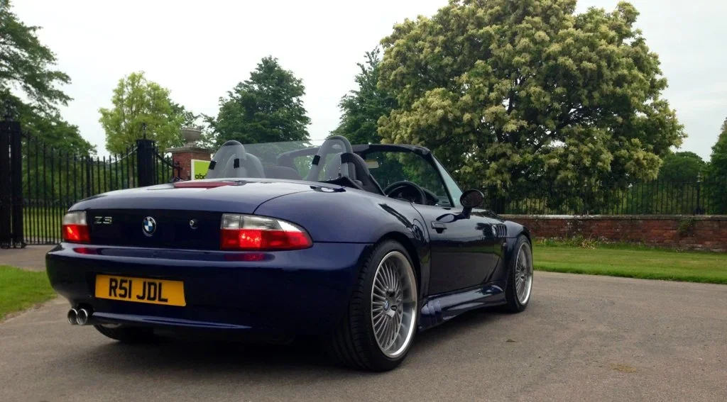

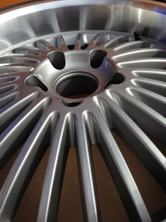

The love was well and truly back for the Z and as it now became a life log keeper it got some cosmetic TLC:
The Beyern Multis got refurbished in my own custom finish with diamond polished bare aluminium dishes and slightly darkened powder coated and painted spokes.
12mm spacer on rear, no front spacers.
Grew a lip spoiler:
Aftermarket side skirt and smoked lenses fitted:
