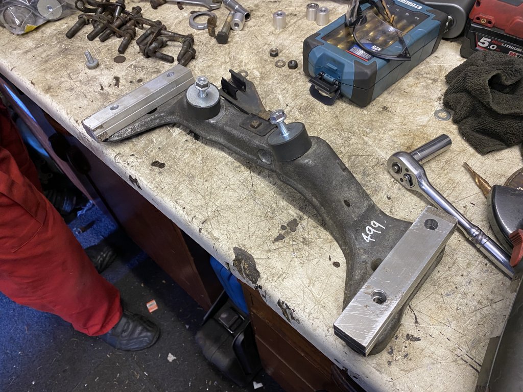

The first big headache this week was the drivers side trailing arm, Dino managed to get a beam and pair of arms from Traceys crashed 2.8 it took a harder hit than we thought. The drivers arm had a very subtle twist and was a nightmare to line up on the beam the final nail in the coffin was trying to line it up with the shock, the angle was all wrong so we needed a new arm. Luckily all sorted and refitted today.
rear end now looking pretty.
with all the spare time I had a chance to make a better job of the gearbox bracket. Now happy with the solution for now.

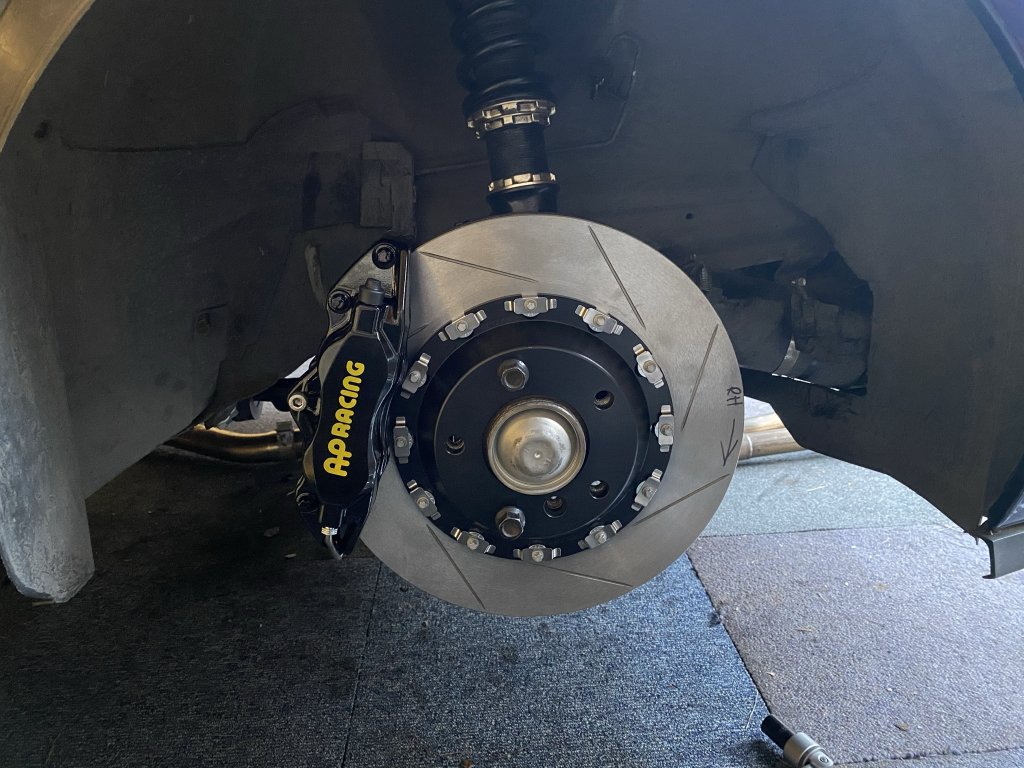

Another little surprise, Dino was well over due a brake upgrade so he ordered a nice big set of AP brakes, these are identical to the brakes on my Zed so he’s got no excuses on track now. They did need a bit of fettling to fit and I wouldn’t expect anything less from Dino.
First up the brakes we just built removed.
Comparison between the two. 300mm discs vs 340mm floating.
First up making room for the new callipers. Remove this tab.
Fitted.
Some chunky pads going in.
The moment of truth they do fit behind the wheel.

Floating rotors was something I had looked into a little but balked at the price of them.
How do the floating rotors compare weight wise to the old rotors? Much weight difference in the calipers?
I had seen that the 340mm brembo bmw sport brake actually fit over 17s too but its v close. Don't want any stones in there.
Would be ott for my car as the brakes are more than fine and wont be anywhere near a track but looks so good...
