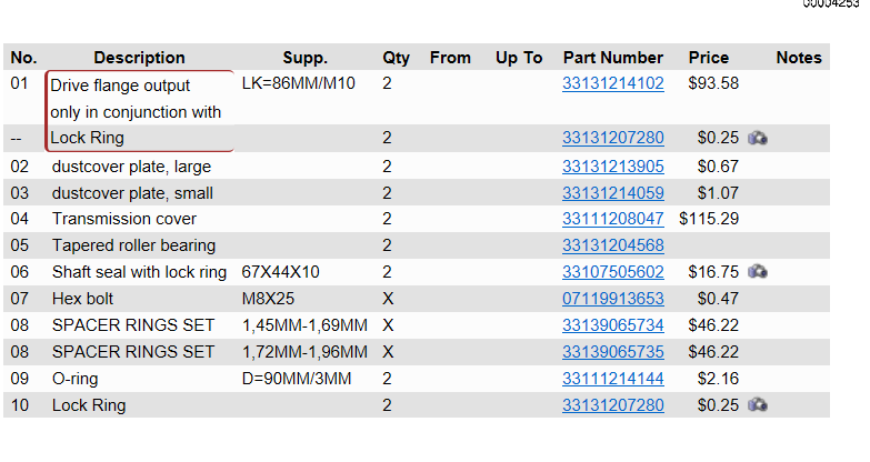

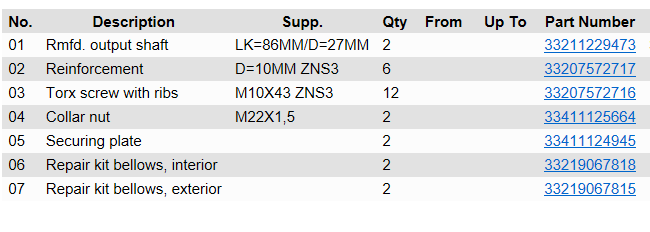

The oil is coming from the output shaft gasket (left element of 6 in Pic 1) and the drive flange (1 in Pic 2).
I think that the shaft seal with lock ring (6 in Pic 2) has failed.
From what I have read, to release the output shaft the 6 torx screws (3 in Pic 1) are removed and the shaft is then free to separate from the drive flange which can then be pulled from the diff housing using a 3-leg puller and some spacers.
To remove the shaft seal there is a lock ring (10 in Pic 2) which is a circlip that sits inside the inner groove shown on the shaft seal. Can anybody confirm this or explain the actual arrangement/method please? Are there any parts other than the oil seal and lock ring that must be replaced at the same time?

Hi, I've never done this job but following the exploded view you posted I would agree with your perspective. If I were to do this I would most definitely replace the "O" ring (no. 9) where this assembly contacts the diff. housing while I was doing it.

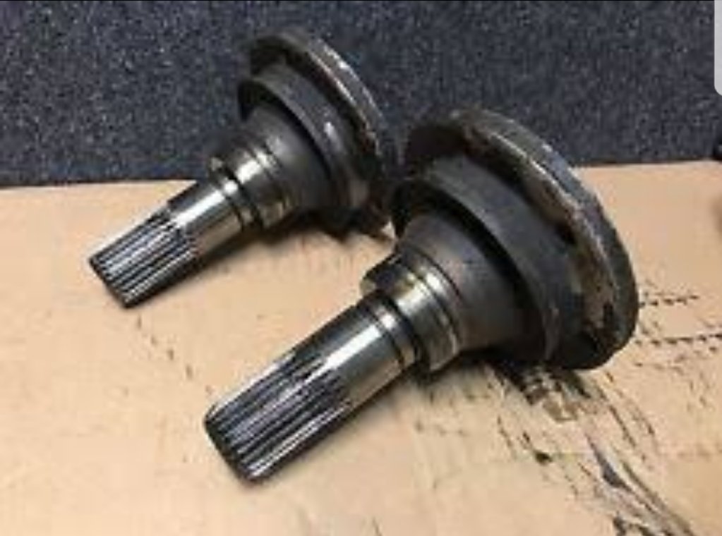

I would say the circlip actually fits on the output drive shaft.
They normally have a circlip set up to stop them popping out it's not like a circlip more just a sprung steel band that locates in a groove on the shaft to lock it in or it would just fall out.
Found a picture you can see the groove on the shaft it locates in to...
It doesn't look like the diffs leaking the oil it is on the wrong side of that flange it would show behind it in my view.
