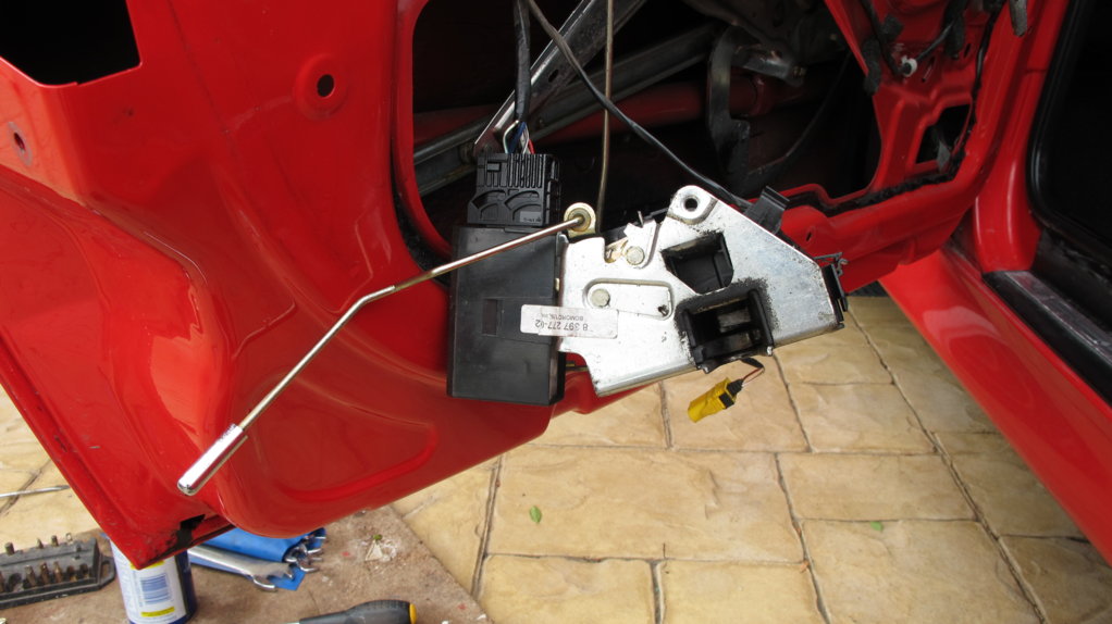

............. but do you know what is involved in getting at the actuator ........
Straightforward procedure but a bit fiddly - door card off, liner membrane off then it's basically unplug components. Note orientation of link rods before you disconnect them - saves some head scratching on which way they go back in.
Good info Colin, always wise to take pictures with your phone too Geoff.

............always wise to take pictures with your phone too Geoff.......
I used to be able to commit to memory - now I need photos to put it back together :whistle:
Just call it a teaching aid mate!=))

I had exactly this issue on my previous 99 2.8. Passenger door actuator was faulty. Oddly it always seems to be the passenger side that fails from what I've seen and read. When you disassemble the actuator from the lock mechanism definitely take photos. It has a strange orientation which had me scratching my head for a few minutes.
