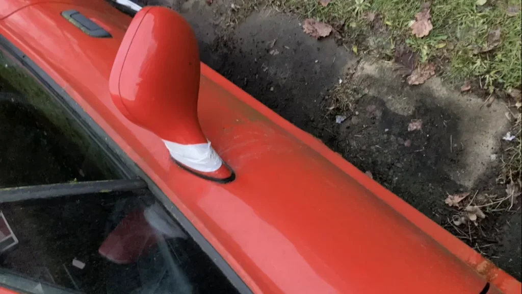

Temporary solution lol - I’ve also noticed that the driver side base is longer and ‘sits upright’ compared to the passenger side - I’ve also been informed that the driver side door was replaced

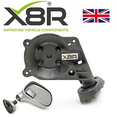

Not cheap but X8R do a composite spindle "upgrade" kit...you can reuse your original cowl on top
