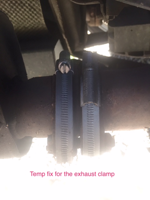

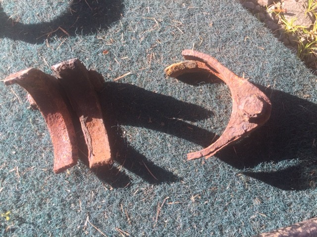

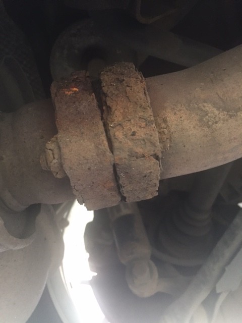

At approx 09:40 the pit lane was opened, we went straight out and stayed out on track for a good 40 mins, the rain came down but despite this I had a great time, near the end of the stint on track I noticed the exhaust noise getting louder, we pulled in to the pits to investigate, for the first time in a few years I had suffered a failure of something at a track, the exhaust clamp that holds the back box on the car had split and the exhaust was blowing badly.

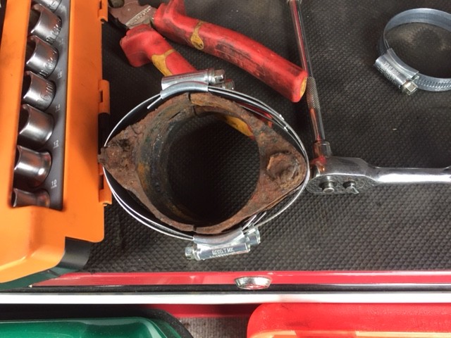

A walk round the pits to see if I could muster up a plan got me nowhere, i took the handle off a bucket I had to try and tie the exhaust pieces back together but no joy. I then had an idea which involved some jubilee bands, a trip in to nearby louth, 6no: jubilee bands later and I had come up with this.
It worked a treat and let me carry on with the day, fitted to the car it looked like this.
We had lost 2 hours coming up with this fix, going to get the parts and fitting etc. I can tell you lying on the ground in the rain is not fun!

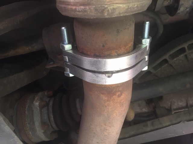

Back home a new exhaust clamp was fitted, this is an after market kit but does the job well. I will maybe double nut the bolts?
