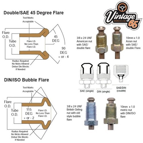

I hope that you posted the wrong image.
That one is needed to join pipes, but it's the wrong one to use when making the ends to go on hoses or into the T-pieces - you need the 4.75 DIN for that.
Ask me how I know this :whistle:
I’ve used this for both @Pingu, no issues to date, you’ve now got me curious!!!
The former pictured is reversible to make concave and convex flares?
DIN has a different profile to SAE.
The DIN tool can only make the convex flares, the SAE tool can do both (hence why it is suitable to join pipes).
You only need to make concave flares on our cars if you are replacing a section of pipe, as all the pipes terminate with convex flares and male unions.

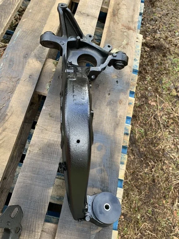

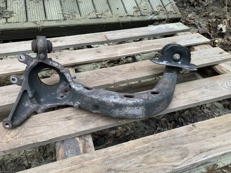

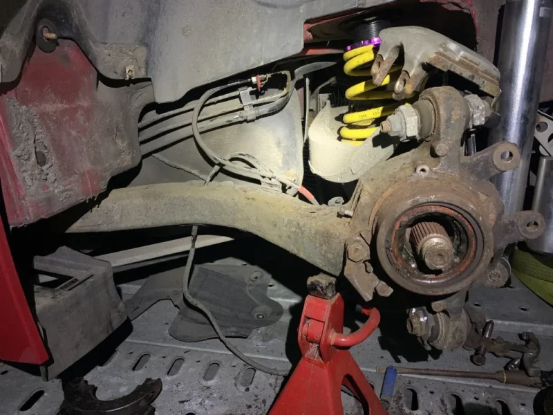

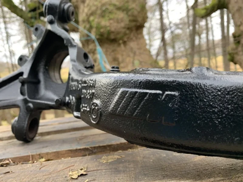

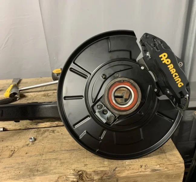

I have a bit of a brake upgrade I want to put on the rear of the car but first things first I need to replace the disc backing plates (this job is not a nice job)
15 years has taken it toll on these parts but don't want to bolt new parts on to this. Discs and calipers are off but you also need to remove the hub to put the brake protection plate on complete. With the hub removed I have taken the decision to do rear wheel bearings also, seems silly not too at this point.
Have the stock rears not been keeping up with your front AP BBK?

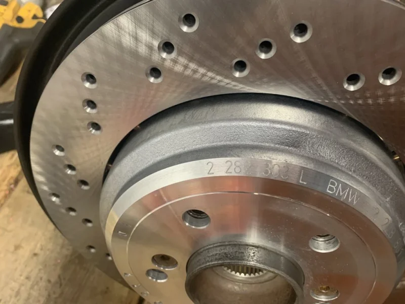

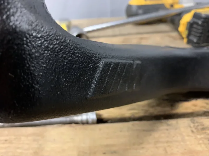

So the rear brakes are finally on car, new ball joints top and bottom, new rear wheel bearings and calipers fitted. Pics attached of the before, during and after, pleased with a the results.

Nice job Brian!
