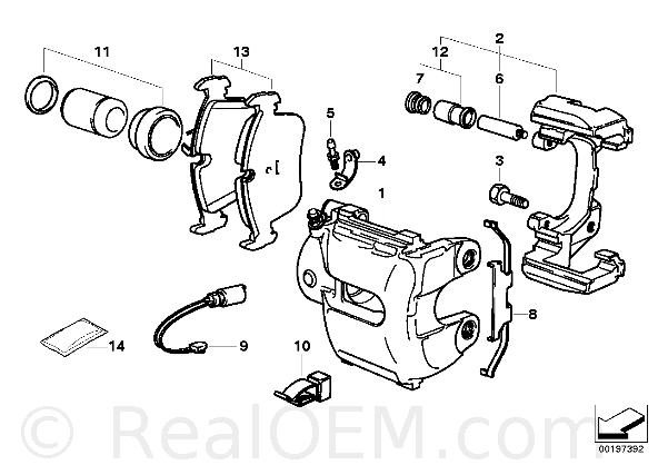

If you can, remove the caliper to paint it. At the very least take the pads out, unbolt the carrier (#2) and remove the rubber bushes (#12).
