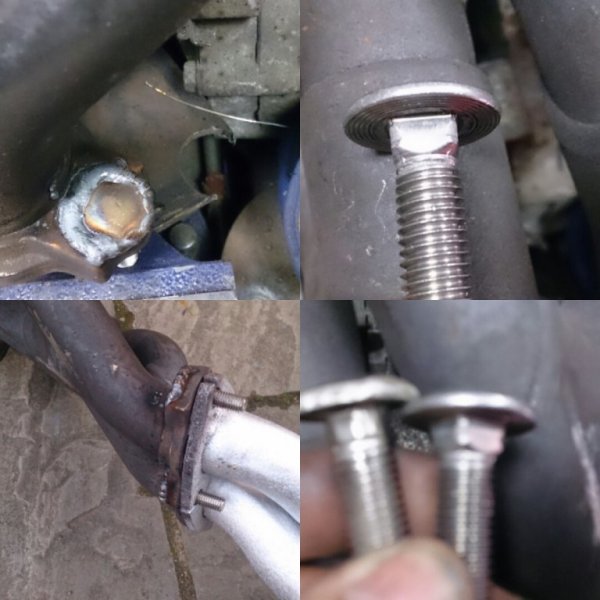

It’s Looks like a shed……only without the skill and knowledge :arghh:….
still, Not bad for a Lean-to =))
also…..Had an email to say my Autodoc parcel is now in the U.K., cleared customs and should be with me by Friday.,..
Could it be a Basingstoke Breakfast on Saturday :thumbsup: I hope so !!!!!
And I could get the front shocks assembled while I’m there=))
Why bother, nuts and bolts work just as well.
Mazza
Nov 1, 2017
175
Bognor Regis
Z3 1.9 M44 Roadster Z3 2.8 Roadster
I still have to get the old ones out yet….but I will use bolts…. Just need to see how long they have to be.
Already got the proper copper nuts. ( from Sopers)
Was going to say Malc, you need to be careful mate, while you're working in the shed some buggers having bits off the silver one on the drive:thumbsup:=))
