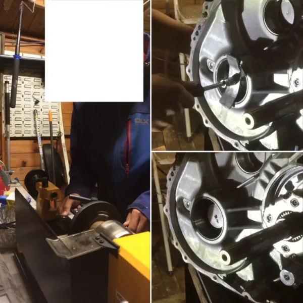

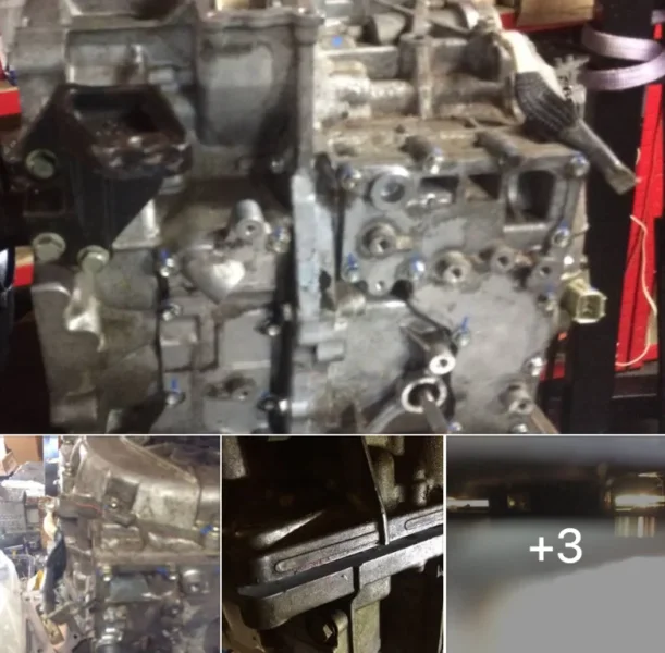

So recently I have the motor opened already and the tasks were removing the gears (CVT gear, differential gears and other speed synchronising gears) and removing those opens up space and its unnecessary to have them and resulted in a weight reduction of 30 kg and then we have looked into connecting the two motors together before they were separated one was used for power and one was used for regenerative breaking so the plan was to weld a gear behind the shaft to make the whole shaft as one and then we welded the outer 4 gears to prevent the inner gear from rotating and now the shaft are connecting the 2 motors and after sorting the 2 caps (sealing 4wd cvt axle shaft for the side) and then its time to seal it back!

Now on each end of the motor, there is two hole in total and that was for the 4wd CVT transmission, we won't need it so we custom made two aluminium discs to fit the hole and there is rubber ring already so the seal should be good!

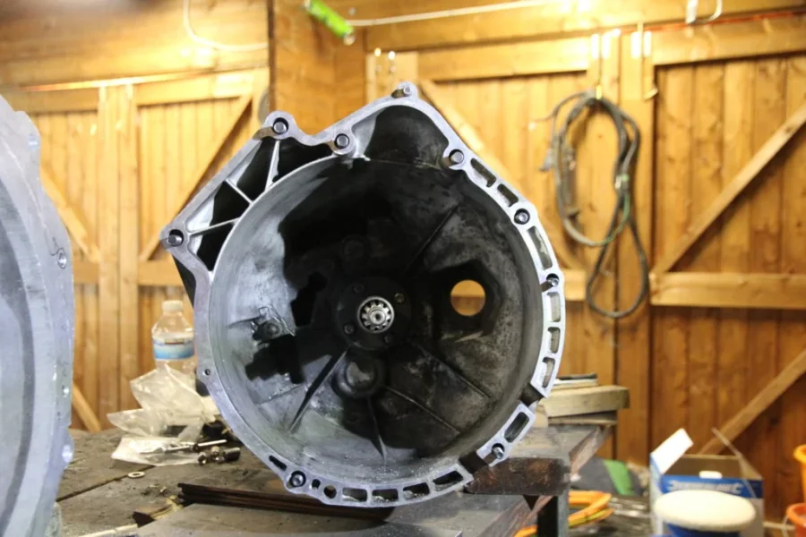

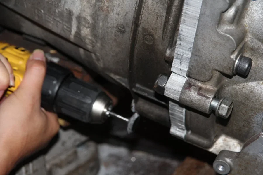

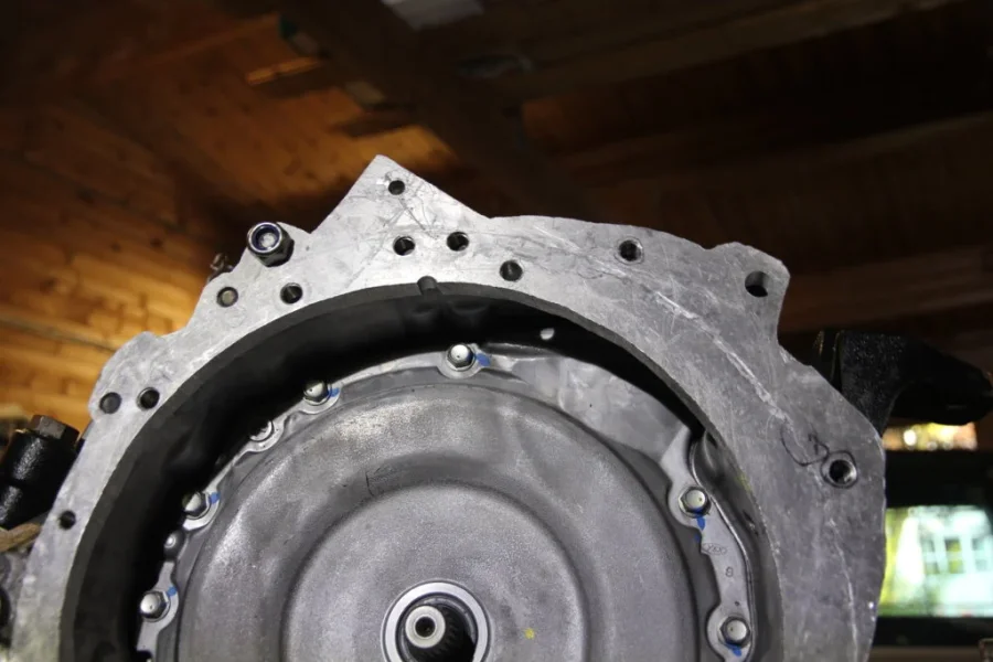

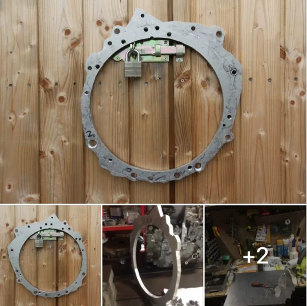

So the adapter plate was crafted out of a 2 cm thick aluminium plate, I had drawn on the aluminium plate and cut it out with a jigsaw and bosch metal cutting blade which made the process a lot faster and easier, after the outer and the inside circle was cut out it was drilled and riveted with m8 and m10s so the bolt doesn't strip the aluminum

@LeoIWH,
Cracking work.
One quick tip (and I agree with @Jack Ratt, my supervisor would have slapped me around the head for wearing loosing clothing when working with machines).
On internal; corners, especially if the metal is load bearing, try and use a radiused corner. Sharp internal corners are notorious for cracking. If you have a small internal radius it spreads point loads and help avoid cracks due to "stress raisers". This applies to most materials including plastic, brick and metal. However, I am not a structural engineer, so it may not apply to your design if it is not load bearing.
https://en.wikipedia.org/wiki/Stress_concentration
https://en.wikipedia.org/wiki/BOAC_Flight_781 was a famous example of stress raisers. The window design changed because of this.
Can't wait to see the next stage!

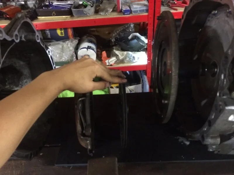

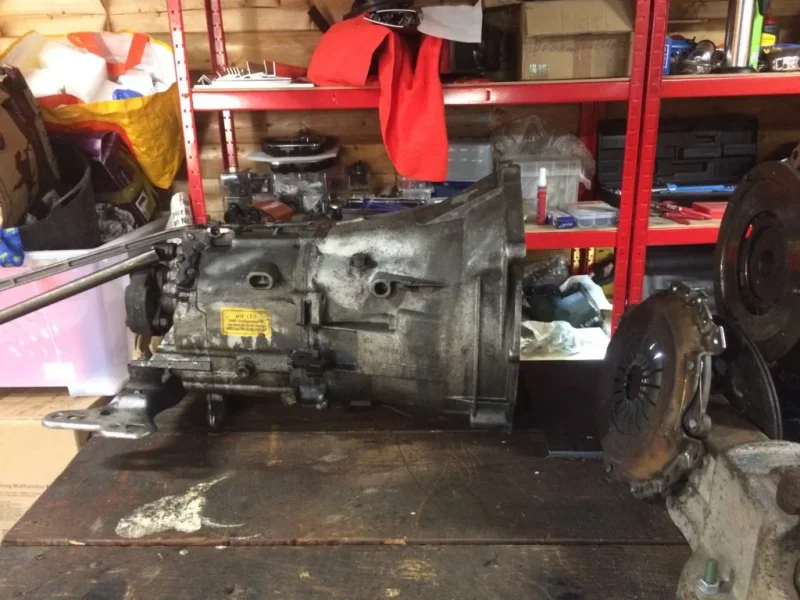

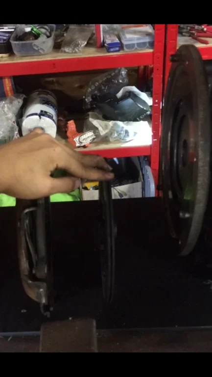

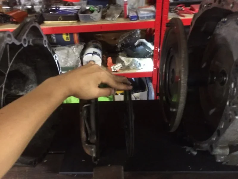

Since the adapter plate was made the development went into connecting the shafts together and we have introduced the clutch and unfortunately we did not consider when the clutch is pushed down and the stress related to the motor's internal component and pump so the effort was wasted and a direct shaft will be made and replacing this (we have salvaged parts from this and may be used in future project) part 1

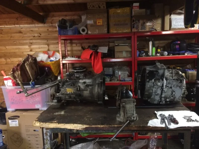

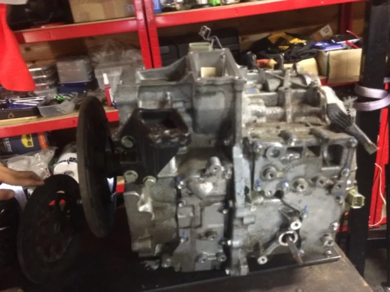

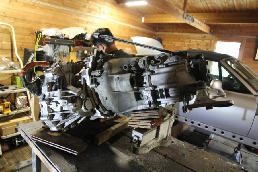

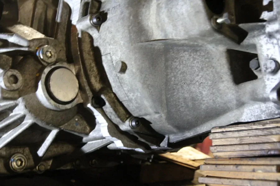

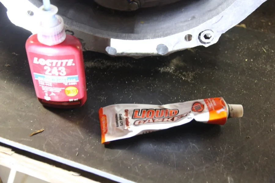

Now it is a matter of bolting the gearbox to the plate and then to the motor, bolts with thread locker and washers and cutting away some parts off the gearbox because the longest bolt we have is too short!

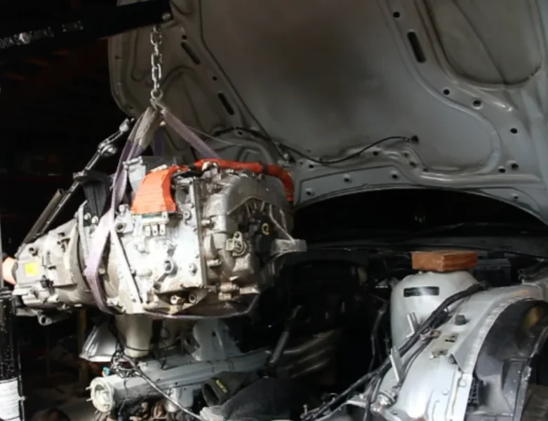

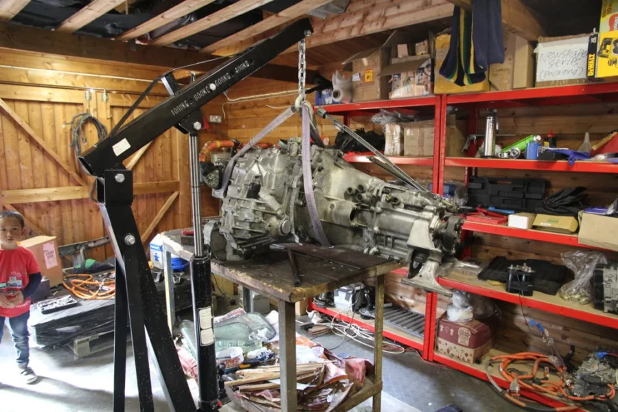

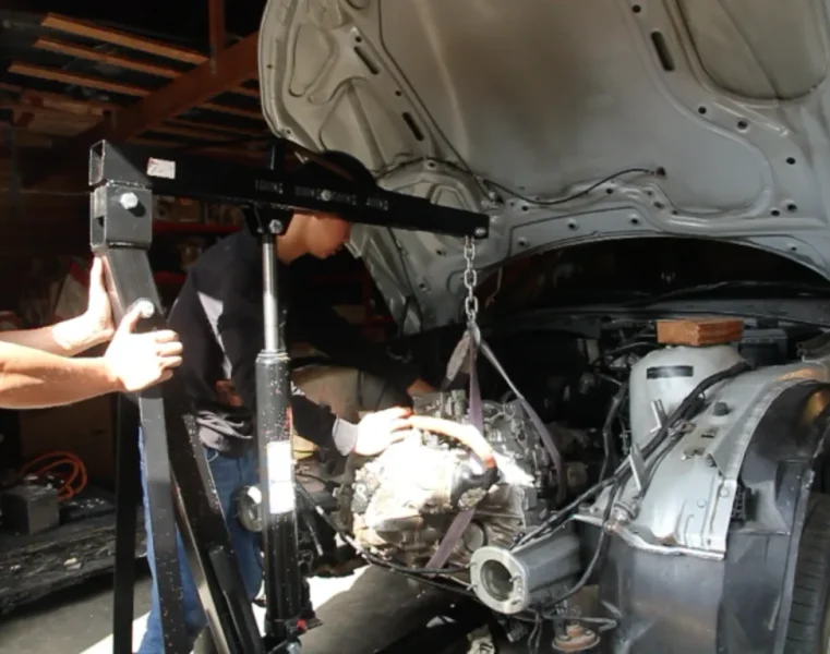

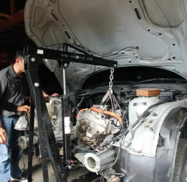

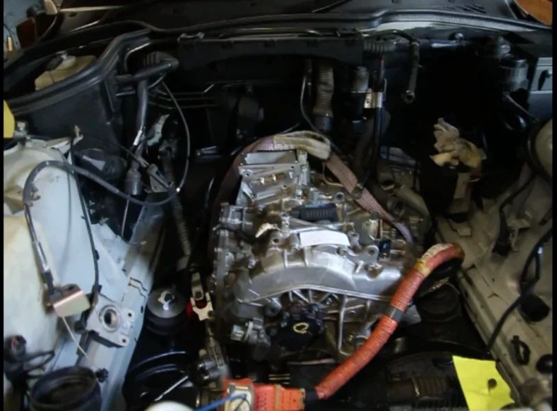

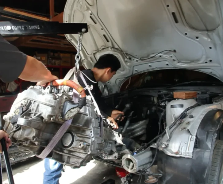

The motor is finally bolted correctly to the gearbox without nasty noise, it was checked again and then it was strapped and lifted by engine crane and it was successfully installed and the next thing to do is test it!
Wow, it looks tiny. How will it compare to the petrol engine weight wise Leo?
