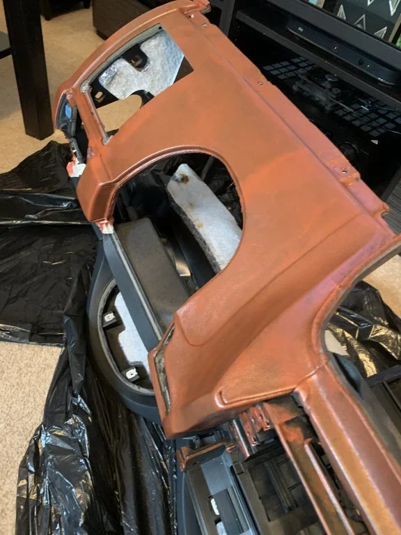

First job was to clean off all the dirt and grease. Baby wipes are great for cleaning down leather
Then some leather prep was used to remove all top coats and key the leather ready for the new colour.

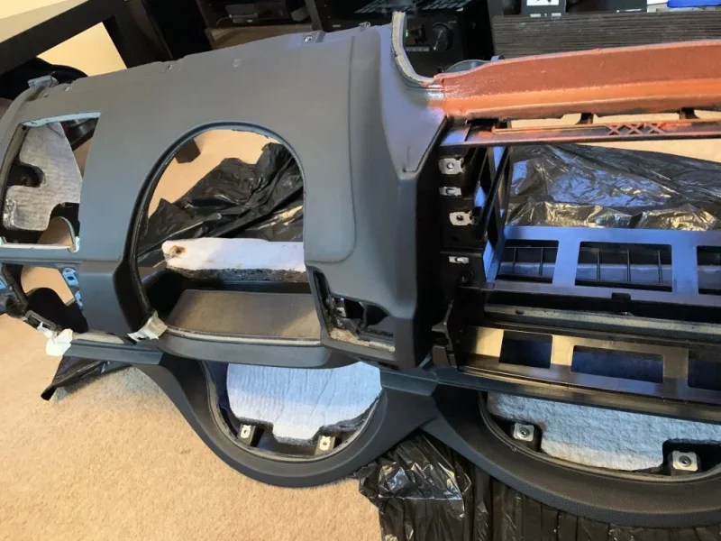

The filler layers were built up slowly to ensure the final surface finish was flat and smooth.
The plastic was then masked up and ready for the colouring stage.

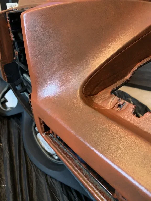

The leather had 6 coats of colour, and then 4 top coats of Satin leather sealer.
Very happy with the outcome.
