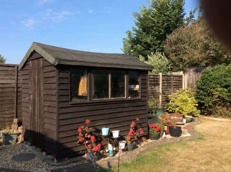

But with all the threads on garages and carports.......I thought it better to replace the shed roof.....
ON THE HOTEST DAY OF THE YEAR SO FAR.......
Main support timbers broken and roofing felt leaking badly so it needs a complete new roof !,
Bloody hell those roof panels are heavy to lift off on your own
Upgraded roof beams from 50 x 38. To 100 x 50. That should stop them bending !!
Then clad them
Using thicker boards as well.
Just have to trim off the overhang with an electric saw and felt it now.....but that will have to wait.......
