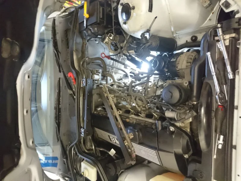

So after @Daz3 kindly sold me his M50 manifold i headed down to the Zed Shed to get some help in fitting it.
SO after a very enjoyable bacon baguette and cup of tea we got cracking.
@Lee had recently fitted one to @Oldguysrule 2.8 so knew what he was doing and his help was epic
after a couple of hours of taking it slowly we got it all fitted up and working.
a brief moment of disappointment as the car was idling high, but only turned out to be a misaligned throttle cable.
the test drive even in the p****** rain was amazing, the car is so much more responsive and very very quick!
old manifold out
new one in

Very Nice! I wonder how much a difference would make on a 2.3L. I have a few M50 Manifolds in storage. I'd have to see if it is California emissions compliant and would need to improve the Airbox flow to make it more effective.
different engine as i think the 2.3 M52 (actually a 2.5) is a TUB variant so twin vanos so cant use this manifold
The difference is night and day i did this on my first 2.8 and as the car learns it gets better and better a great modification :thumbsup:

Have you done the ECU and BBTB as well?
And does it sound different?
Can’t believe how many pipes are crammed under the manifold :nailbiting:
I’m looking forward to doing this, been toying with the idea for years!
Nope bbtb and ecu are next up but going to see what this does on the dyno first.
Sounds a bit deeper and more noise at lower rpm. Getting more exhaust pops too

Nice, I like the sound of more pops especially after following @Lee Coupe about..snap crackle pop!
Ps if you keeping the ASC you can have the ASC body bored out to match the TB.
