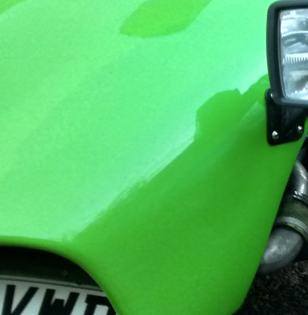

What kind of reflector? Picture or link to supplier? Thanks
Like these. Picture of how they look on car included. I think they do rectangular ones also.
